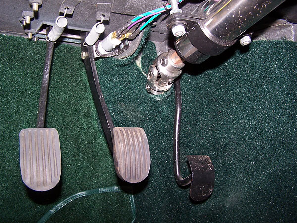

Check the switch. Look inside the car, at the top of the brake pedal you should have something like this : DanMasters-GE.jpgbrakelightswitch001.jpg
Check that it's working etc, it should just tough the pedal.
Cheers & goodluck

 Ruled the brake switch out by joining the two wires, brake lights didn't come on.
