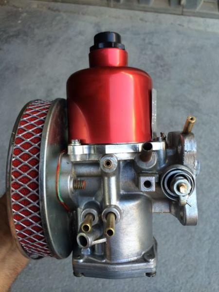

I found this in my collection of downloaded images .. this is a HIF44 though.
Edited by gazza82, 06 October 2014 - 02:59 PM.
