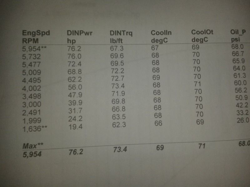

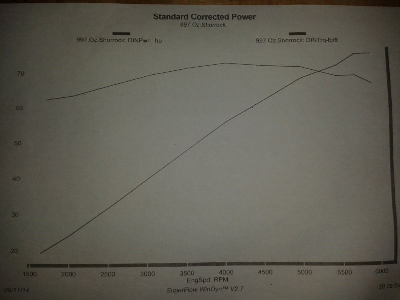

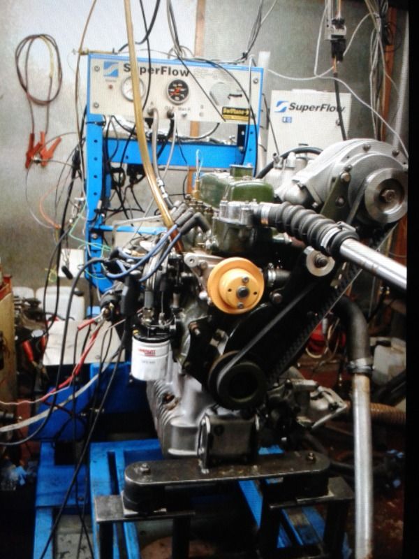

This is the last two Shorrocks engines I built. Top one is based a 850, the other a Cooper 997.
Both run H4 SU carb.
The 850 was a bit more modified and had 72 hp on dyno, the 997 had 76.

Posted 14 November 2014 - 05:25 PM
On that dyno a std 997 would show high 40s hp, so with mild tweeks and blower it is about a 65% power increase.
Running 8lb boost and 32 deg full advance.
Two limiting factors on the 997. It has std 3 syncro box so aim was std Cooper S power and wanted to keep blower to 6000 rev limit. With pullys I had made, the engine is at 6500 when the blower is at 6000.
The power is still climbing at 6000 revs.
The nice thing with the blown 997 is the torque curve. Over 60lb of torque from 1500 to 6000 revs.
Have done 5 Shorrocks engines over the years, not sure where other dyno sheets are. I'll have a dig around.

Posted 15 November 2014 - 09:46 PM
Are they corrected flywheel figures?
#26 OzOAP
OzOAP
  • 387 posts
  • Location: Surrey
Posted 15 November 2014 - 11:46 PM
Yes.
