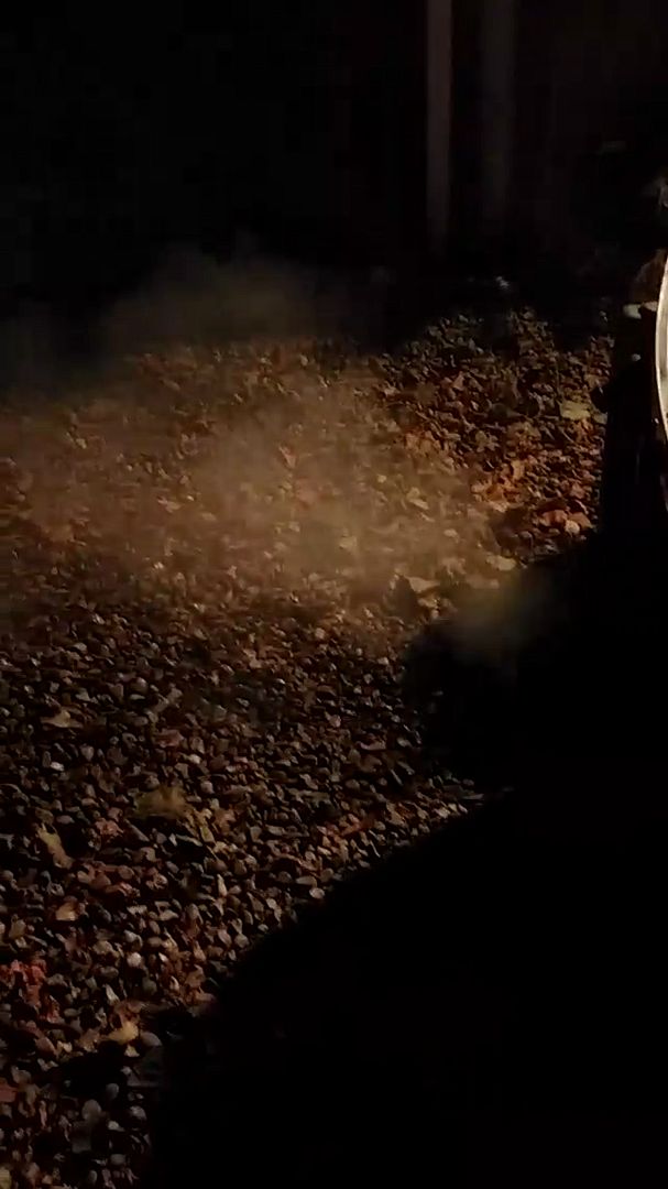

Part 5
Well it's not. On engine reaching full operating temperature it's pissing out oil enough to give a hell of a shiny coating on the gravel drive :(
Video attached
http://i1111.photobu...1029_171146.mp4
So my conclusion is oil control rings as there seems to be no issue with the engines compression that I can tell of
Exhaust manifold removed
Cylinders 1-3 clean if running slightly rich
Cylinder 4 pissing oil like no tommorow :(, So piston 4 has leaky oil control rings :(
It then catches my eye that 5w40 fully synthetic is not what the manufacturer recommends for the micra k11. The recommendation is 10w40 part synthetic.
Therefore I come to the conclusion that the car has worn oil control rings that are causing oil to burn once the engine has got to temperature as I have fitted a lower oil viscosity than recommended.
My plan is to add some oil fortifyer to up the viscosity of the oil to prevent oil burning. If this proves successful drain the engine and fit good quality but higher viscosity oil than recommended.
What are peoples opinions on this idea

maybe its just no 4 oil rings are just clogd up as one would of thought all four would of worn together,if no obvious sings of scored bores maybe try penertrating oil or disel in no 4 for a few days or more,worth a try as you will do no harm,good luck

have you checked the engine vent's are clear ? - they can exaggerate a minor problem if blocked
as above if engine has stood - maybe the ring is a bit blocked up
