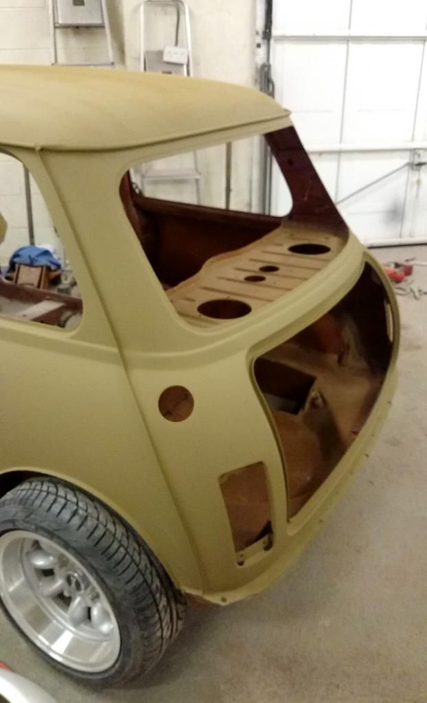

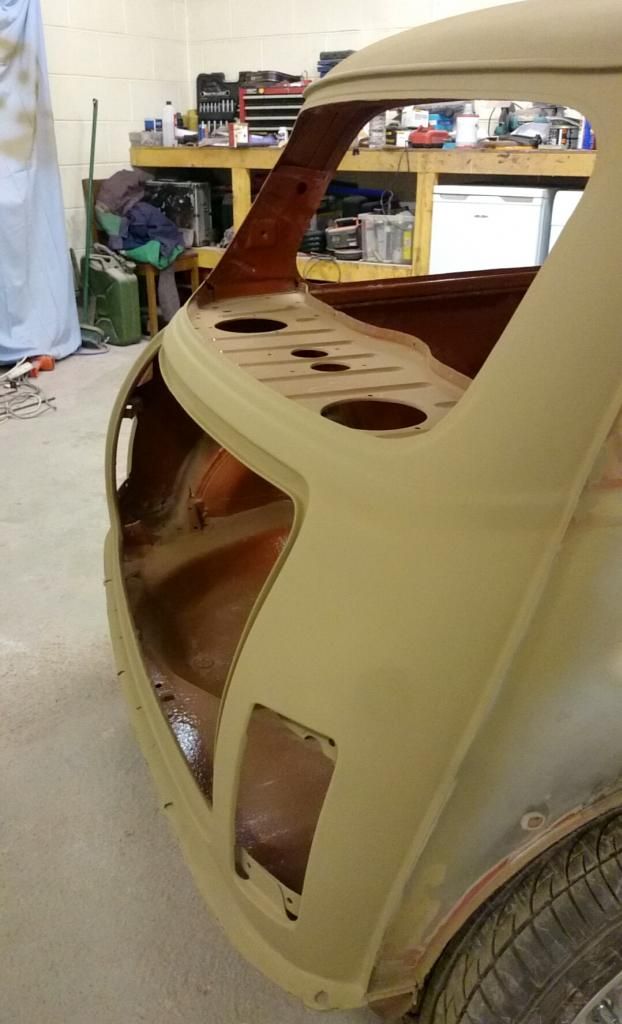

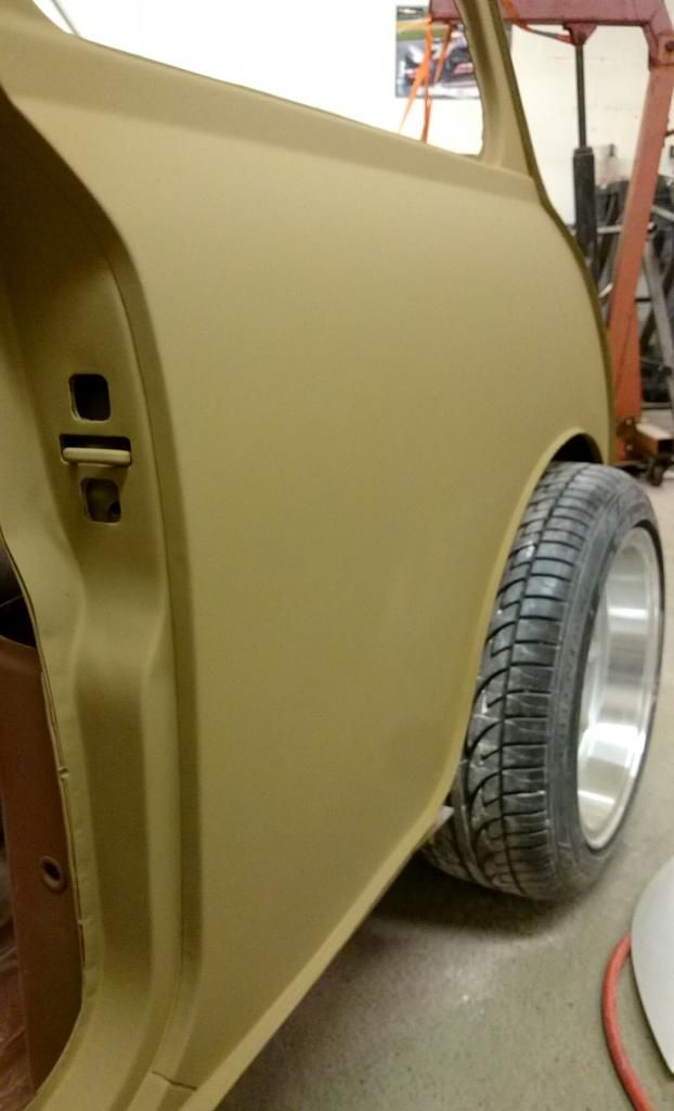

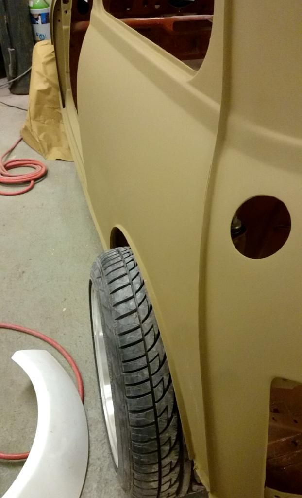

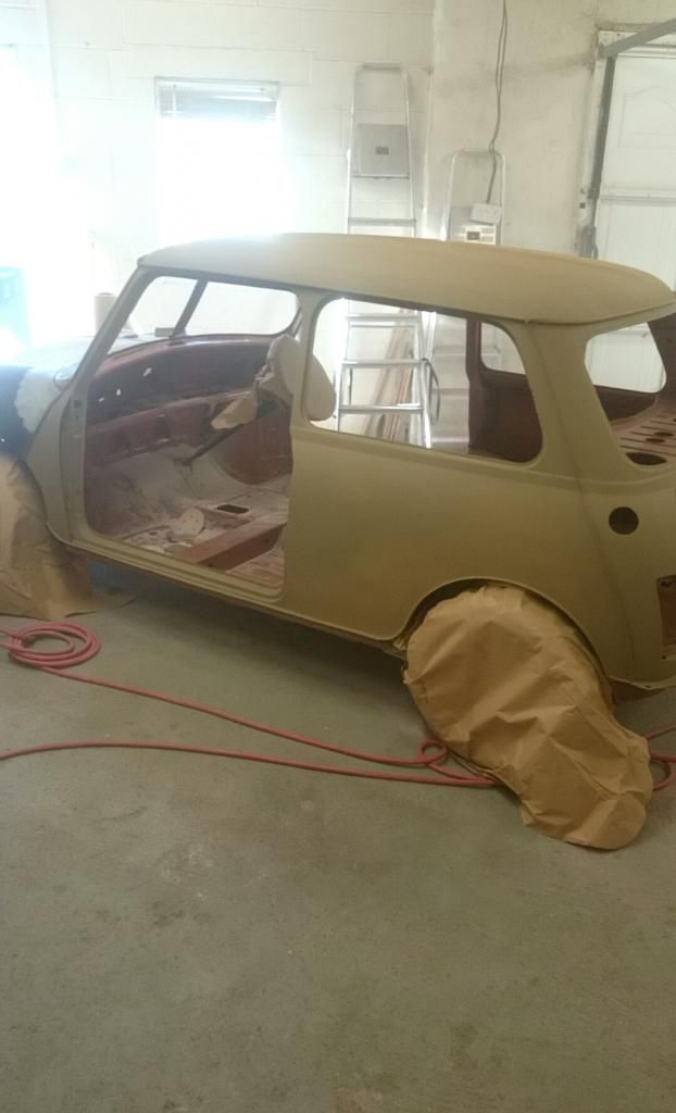

Got the roof, back end and the n/s quarted finished yesterday roof had a little dent in the corner due to being used as a shelf by previous owners!
so got the garage heated up,hooverd, floor soaked  to keep dust down
cleaned,pre cleaned and tack wiped all the pannels i wanted primmed today and got on with priming it!
I used u-poxy etch primer and i done it myself as it need to be flattened and primed  again at the body shop when it gose for paint!
Drivers side will be gettign finished next week then onto repairing the doors :proud:
Heres some pics after a good few hours with the space heater on full blast!
Cheers!

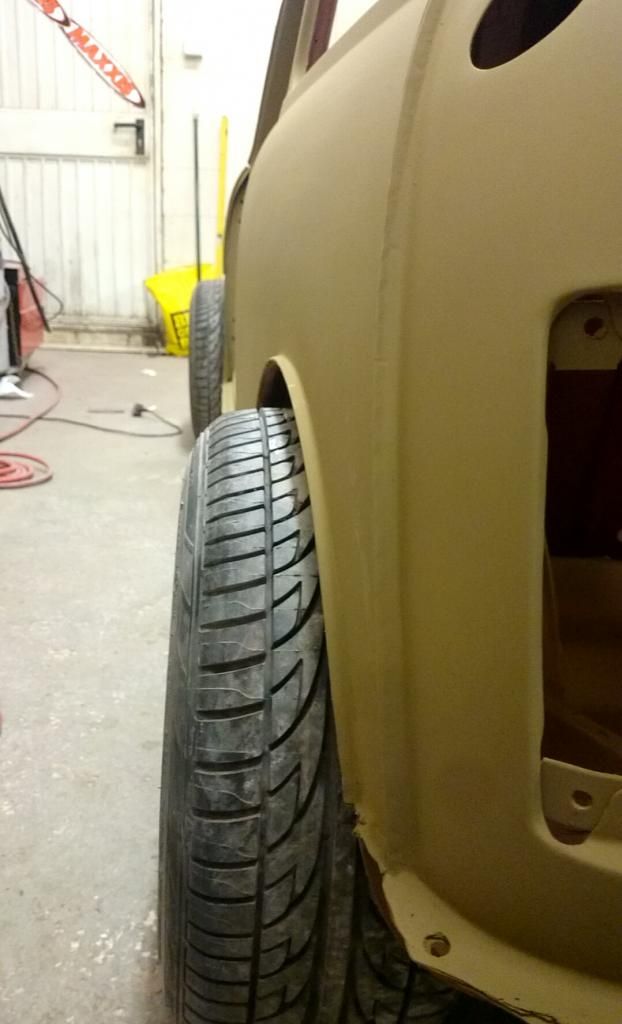

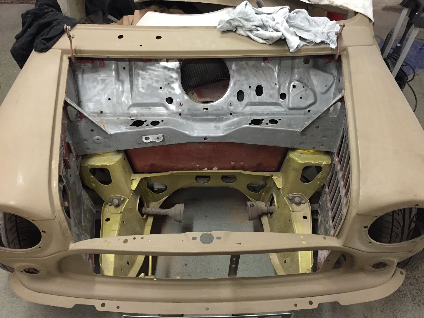

Hello again all...
been a while how ever progress has been slow... due to holidays in Florida,Orlando..New Jobs.. New Road Car.. And a new Megane Sport Race Car...
how ever spent the last few weeks starting back working on the cooper,
(mainly because on 2 weeks christmas holidays)

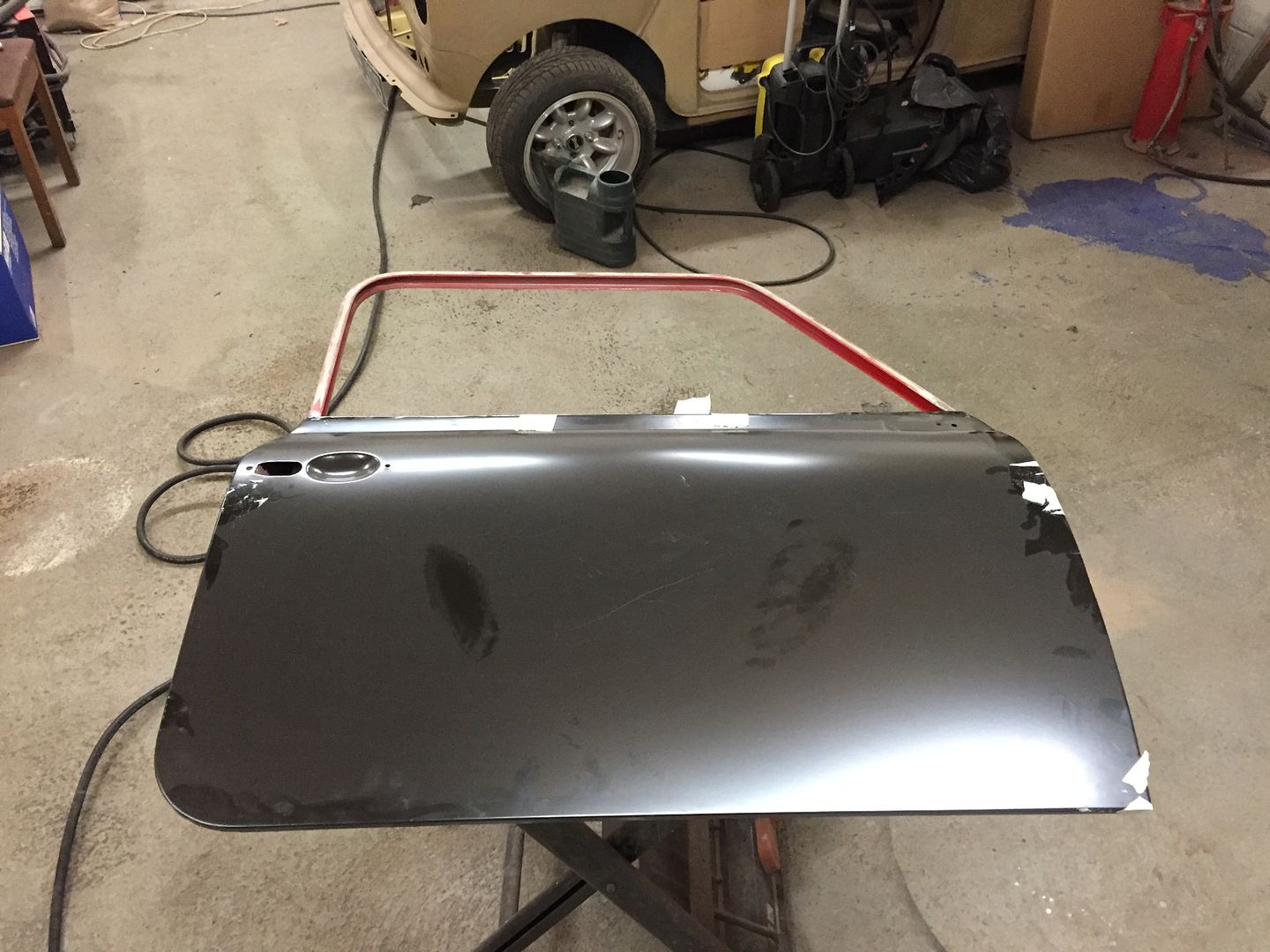

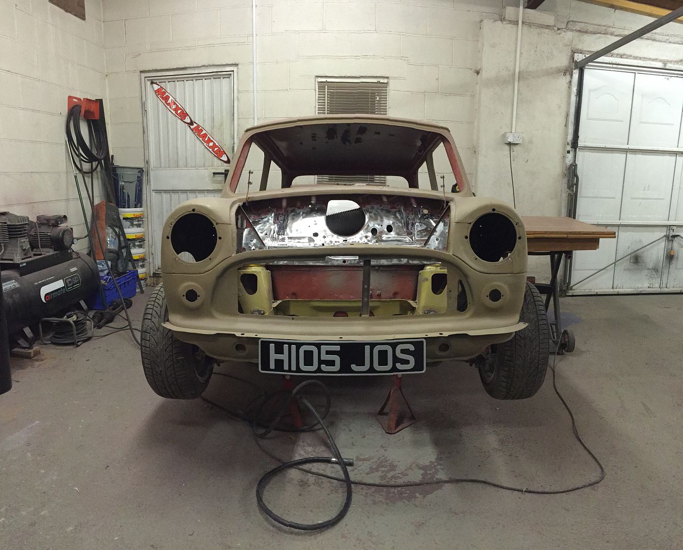

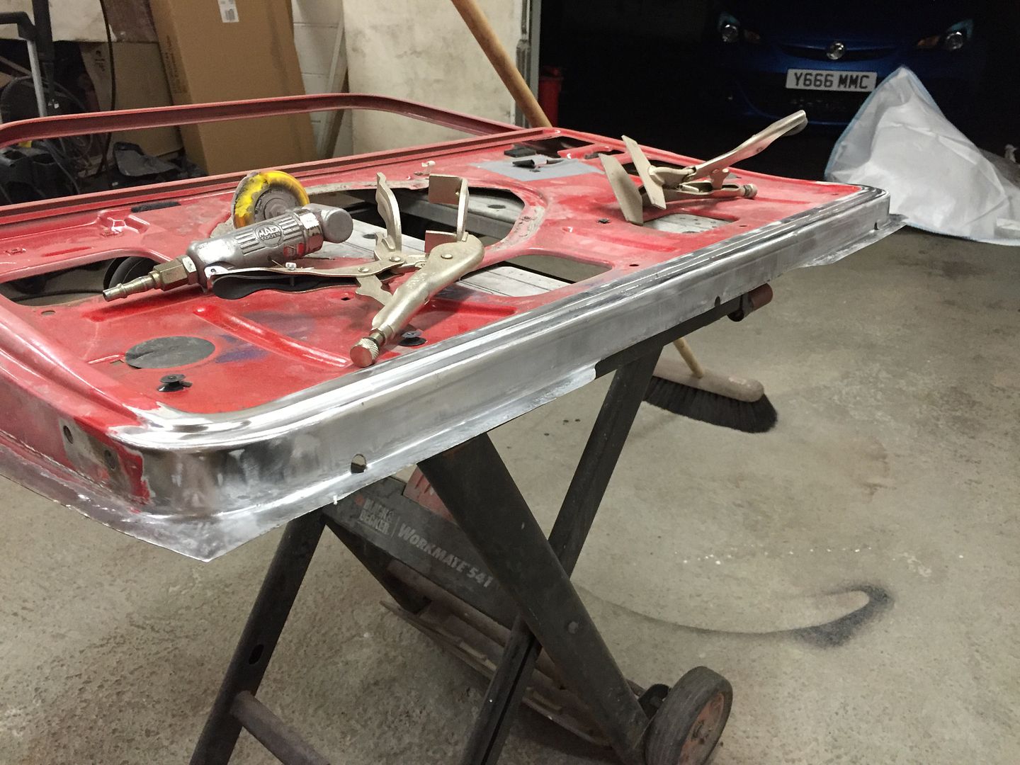

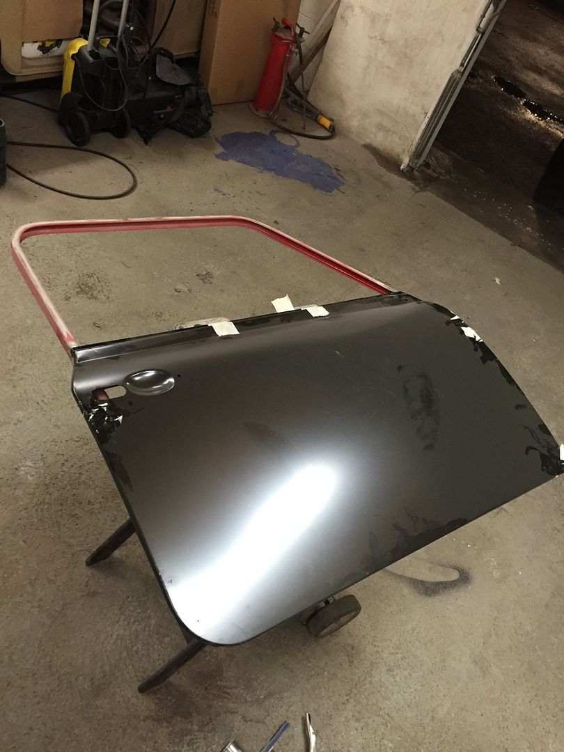

started to strip the door and lightly blast the bottom of the door frames!.. drivers door bottom so decided to get a replacement pannel and also decided to go for genuine door skins after hearing some storys about copy door skins!
also been prepping the enigne bay!
here are some pics!
more updates soon!
