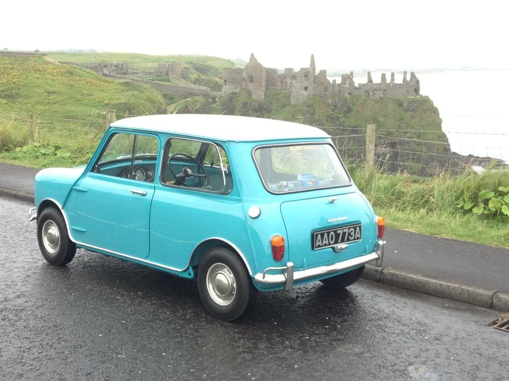

I found the problem, was a bad earth, all fitted and working now and I'm very happy as you wouldn't know its there until it comes on.
I looked for ages trying to find something subtle but couldn't. So I made this from scratch, and hence you can't buy one like this, as far as I know.

Looks good! :mrcool:

Neat idea. How have you attached it and where did you source the led strip from?
A very nice colour combination if I may say.  :D Looks somewhat familiar .....
