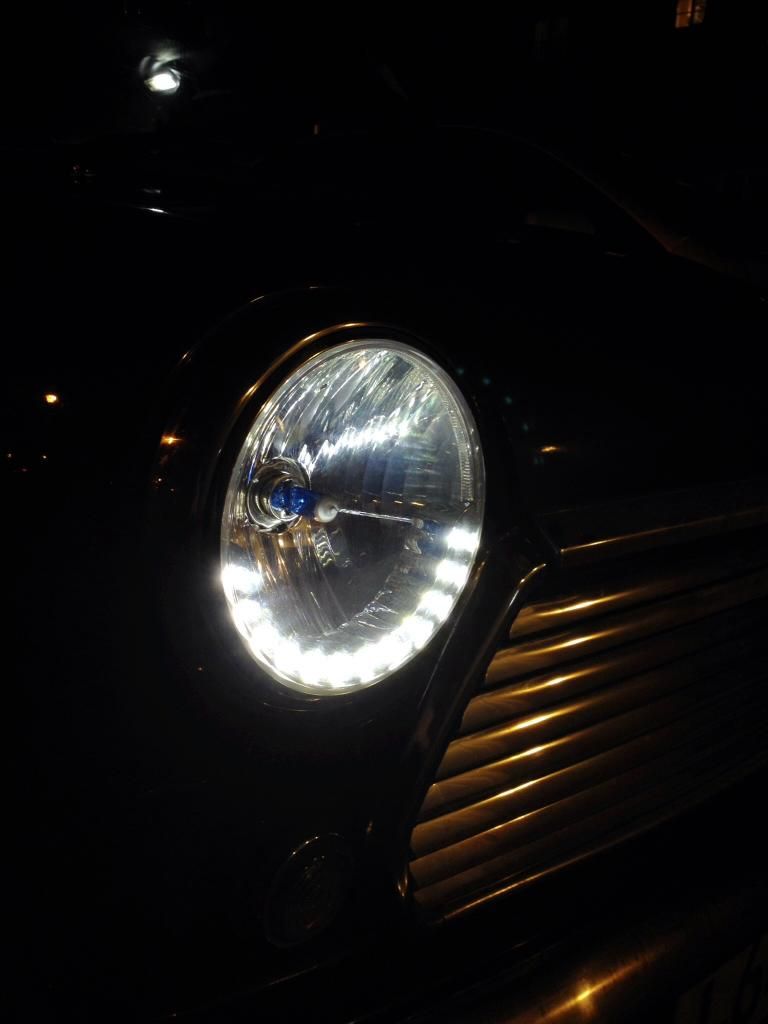

I have also fitted uprated xenon style h4 bulbs but have managed to get these fancy led side lights:
Looks great, were they difficult to fit?

Not at all, the LEDs are a part of the headlight so a straight swap of the old unit, then just drop a new bulb into the centre . Looking at changing the xenon bulbs for LED CREE soon too.
where did you get them from?
