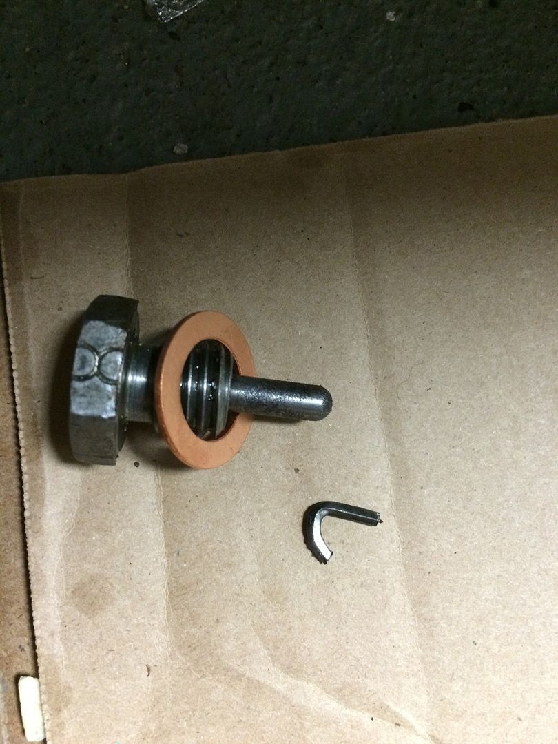

Just did an oil change....found some metal on the plug.... Any idea what this could be?

It looks like the insertion tang off a helicoil insert. Most likely the sump plug has been helicoiled and this has ended up in the sump instead of being removed when the helicoil was inserted.
Now that it's out there's nothing to worry about, the magnet on the sump plug has done it's job.

As above!

Yes! I know that piece just didn't think of it! that's great news! Thank you guys. Was kinda worried for a bit...:)
