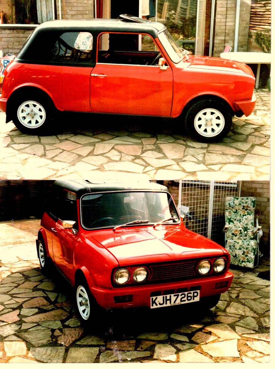

one thing I did on one of my de-seamed mini's
was to close the side rear window up a bit
added a bit of strength to the back end (not saying it would look good on yours - just an option)
sorry photo's taken with a potato in the 90's
