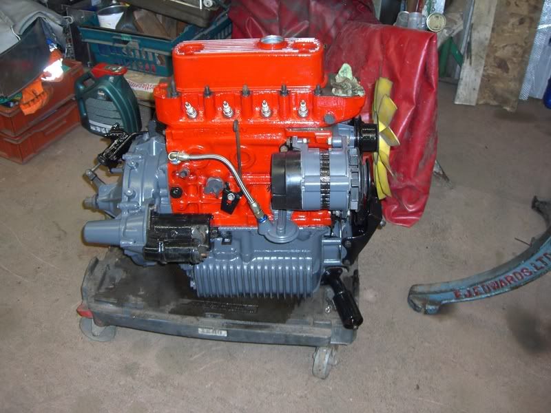

From the grotty engine on the previous page, to this:
Amazing what a lick of paint can do!

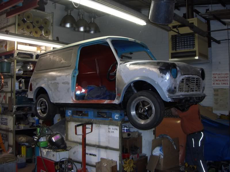

And just to see what it looks like (and for purposes that will become clear in time ;) ) I've put it back on wheels. Looks awesome!

:thumbsup: Not really. We've been working horrible shifts at work, so I've not been in the unit. And every weekend I've had to do something else - mainly sorting my other one out, and pulling the MPi to bits. But now thats about done I can get on with the van. Just need to get the driveshaft assemblies off the subframe of the mpi, clean em up a bit and put them on the van. Then it can come down off the box its on and I can carry on again.

Nice to see its coming together, i take it that the head i sold you did come good after all that muckin about? Sorry about that i would of put it up cheaper if i'd known. Clever idea with the box never noticed it was on a box till now :thumbsup: lol!
