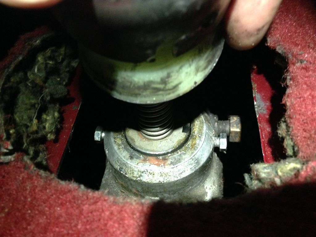

The problem is when you fit a standard stick back in the standard dowls that tapped into the alloy housing, the right hand one had a pair of flats on it that fitted into the slot on the ball of the gear lever that stops the stick doing a 360.
What I did when I removed mine was tap the alloy to 6mm in the 2 holes the pins were in and use 2 6mm bolts. The left one just screws in the correct length to prevent the ball jamming, the right one i reduced the tip down to fit in the slot on the gearstick, this bolt was longer and I fitted a 6mm nut on it, insert the stick, slide the top cover on and insert the 6mm left hand bolt with locktight and just nip up, the right hand fit the 6mm bolt with the reduced peg into the stick slot, now wind the bolt in until you feel it binding on the ball of the stick, now back it off to allow propr gear selection and then lock up with the nut with locktight on threads and nut.
Reference your comments
This is a photo of my gear stick
A7F2DBBF-11CC-443E-AE3E-10441E65F767_zps
So basically I need to put a nut onto the end of the right bolt so that the but sits in the slot?
Will this stop it doing a full 360?

You need to take your stick  out and see if the right bolt has a peg on the end which fits into the slot on the stick to stop it doing a 360, if yours is not long enough just get another longer bolt and file a peg on the end and use a nut to lock it up at the right depth, this is done when the tin upper cup is clipped over the 6mm bolts
Re-read my second paragraph again it explains the above in depth, if you have issues I'll ring you if you PM me your number James
Yeah I'm missing a "peg" on the end of the right bolt.

That explains the 360 on the stick
