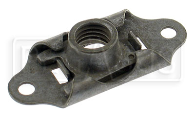

#14 nicklouse
nicklouse
  • 19,066 posts
  • Location: Not Yorkshire
Posted 03 March 2015 - 08:20 PM
I know what I woyld using rather than rivnuts.
But not sure where you would get them. sonikk would do though.
I would call them floating captive nuts.
Just found some.
Edited by nicklouse, 03 March 2015 - 08:22 PM.
#15 spiguy
spiguy
  • 1,537 posts
  • Location: UnderTheCar
Posted 03 March 2015 - 08:36 PM
Interesting Nicklouse, I also work in a related industry and we use something similar on some of our products mounting brackets. I think rivnuts will make for an easier quicker install though, and will do what I need of them.
