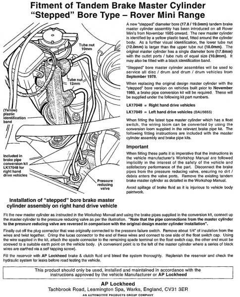

I would agree it sounds like classic symptoms of a failed master, but you won't get a rebuild kit for a black band cylinder. Spares support for them ended in the early '80s when they became the subject of a service replacement bulletin. They were all supposed to be swapped for yellow band cylinders which in all likelihood is what you will have to do now. Try adjusting and bleeding first by all means but I don't think it will gain you very much.
Below the service bulletin referred to by Dan above
Attached File  image.jpg   95.8K   8 downloads
