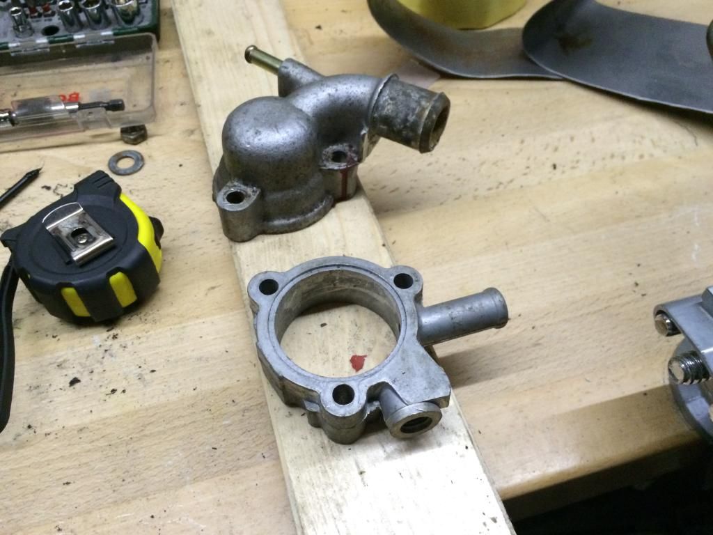

So they have a set up like this?
6EC2FF30-5871-4BD1-B1A0-9024A0CCA776_zps
Mine but never used the adaptor and I belive the top bit is MPi both might be but I have no idea.
Doh!  Just realised, that sandwich plate is the same as mine!

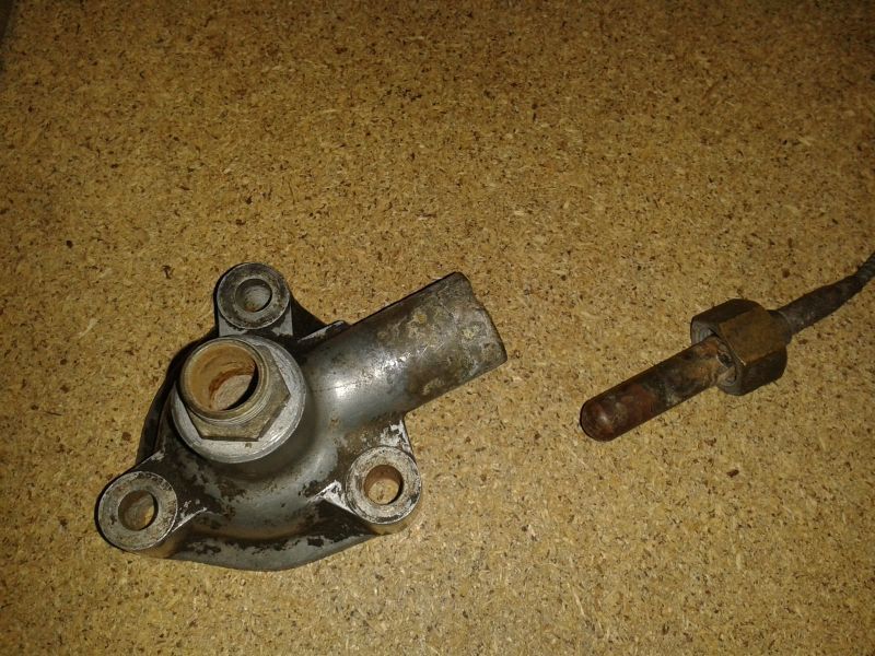

This is a pic of it with the end of the capillary tube from the gauge showing the bulb:
Just occured to me though, there is no rad bracket tapped hole on this anyway so how would I secure that ? Maybe make a small bracket to attach it to the nearest housing bolt?

That is an early metro stat housing. There is normally a black plastick plug in there not the thread converter. It is actually what I thought you might have. My concern is with the bulb fitted you will not be able to fit a stat.

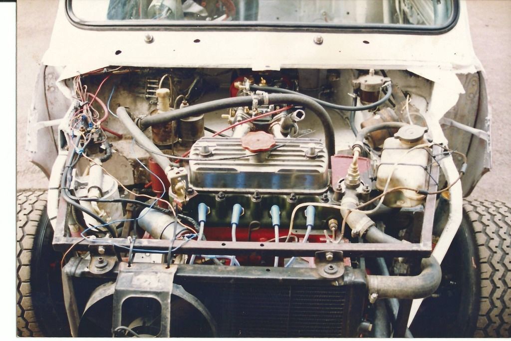

Here is how I used mine. Might be slightly different.
C363869D-A2CA-4165-BEAC-5E7924B83885_zps
Still have it somewhere.

hmmm. It may be the same as the one from an early metro, but it was definitely from my dads 60's van! he only had it from the early 60's for a few years, selling it when the subframe broke (was used in my grandfathers building business).
So, how else can I plumb it in? I don't have the traditional sender hole in the cylinder head, being an SPi...
