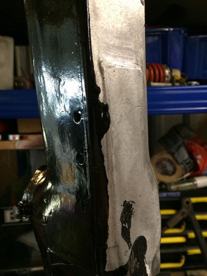

And what were these to holes for? Rear right just before where the stick goes in.

Could you take some pictures for me would good for info for me and others. Also if you have th two holes rear right (drivers) on it what is there?

That is a 5/16" UNC tapped hole for the original Cooper/Cooper 'S' exhaust pipe clamp.
And the rest of the holes?

I've got the two holes on the drivers side, you can see in this photo. I can take some more detailed ones this afternoon after work.
