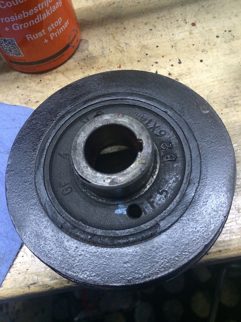

Ok here is a picture of the rear of my damper. A standard one here you ca easily see the rubber joint. When you look at the front you just see a grove.
17A787BE-E1C1-4903-B822-1FC7E7B4645C_zps

First time I've seen two parts share a woodruff key. IMHO each should have it's own woodruff key.  Damper side of machined groove looks damaged. Any new damper would probably do the same thing even if secured with a new key.  Maybe a good machinist could machine a new groove in situ?
