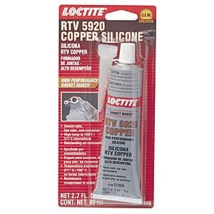

I use a loctite copper coloured hi temp seal, cant recall the number now but got it from halfords. Works fine on my 1293 supercharged with LCB, use it at all the joints, its flexible and is easy to apply.

Loctite 5920 I'm guessing.
http://www.loctite.c...d=8802627420161
Yep, thats the stuff.

I guess I am not that out of touch or off the norm...
The bits below are from the web link posted by Fenghaung concerning Loctite 5920.
(Known as LOCTITE 5920 )
LOCTITE SI 5920 for flexible flanges, machined or casted surfaces, high temperature resistant
Technical Data
  • Colour: Copper
  • Service temperature range: -60°C - +350°C
  • Tensile shear strength: 1.4N/mm²
  • Max. gap: 1mm
  • Skin over time: 40 min.
  • Cure through volume in 24 h: 2.5 mm
  • Strength: Low
  • Cure method: Moisture (Silicone)
And the small print just below the product number on the tube "High Performance RTV".
