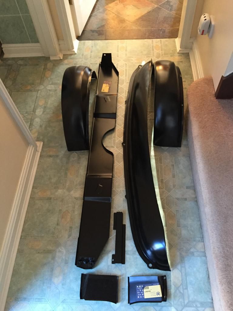

Posted 28 December 2020 - 12:15 PM
The replacement heelboard before fitting
c3783924f1c260fc992204d994fdaa0666b3f9cc

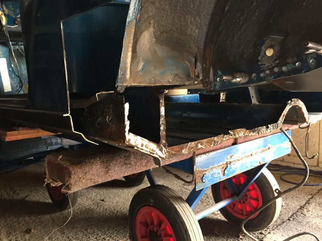

Posted 28 December 2020 - 12:16 PM
Old one removed
29781ff0103003c01b9d3b1cf07dba10163957a3

#44 Dave45
Dave45
    Just On Tickover
  • 7 posts
  • Location: Leeds
Posted 01 May 2021 - 07:58 PM
Apologies for not replying. Ive just seen this! I did the same as you and went for the later type panel. I made a bit of a mistake though..
Because the car is so rotten and in danger of snapping, I did one side at a time. I welded half the heel board in on drivers side, then offered up my new subframe to weld the passenger side. It fit a treat! However the sills wouldn't align. Turned out I had a duff subframe that was 1/4" not wide enough.
Ripped it out and used a full panel second time around.
Live and learn! Thanks for that! Going to study your pictures!
