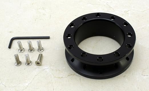

There are sandwich plate adapters available to go from one hub type to a different wheel.  I don't know if one is available for your specific combination.
The 70mm circle is used by Momo.  This should not be confused with the 74mm circle used by Nardi... so check twice before starting your shopping.

What I was suggesting was an adapter disk.
You said you were looking at quick releases with a 70mm bolt circle.  The adapter disk would have a hole pattern on the 70mm bolt circle in the center and be large enough to have the Astrali bolt circle towards the outside.  You would bolt the disk to the quick release using the 70mm bolt circle and then bolt the Astrali wheel to the larger bolt circle.
As I said, I don't know if there is such a disk for the wheel you have.  There are such disks for adapting Nardi wheels to the Momo pattern.  I suspect there are also such adapters for use with Grant and Moto Lita wheels.
