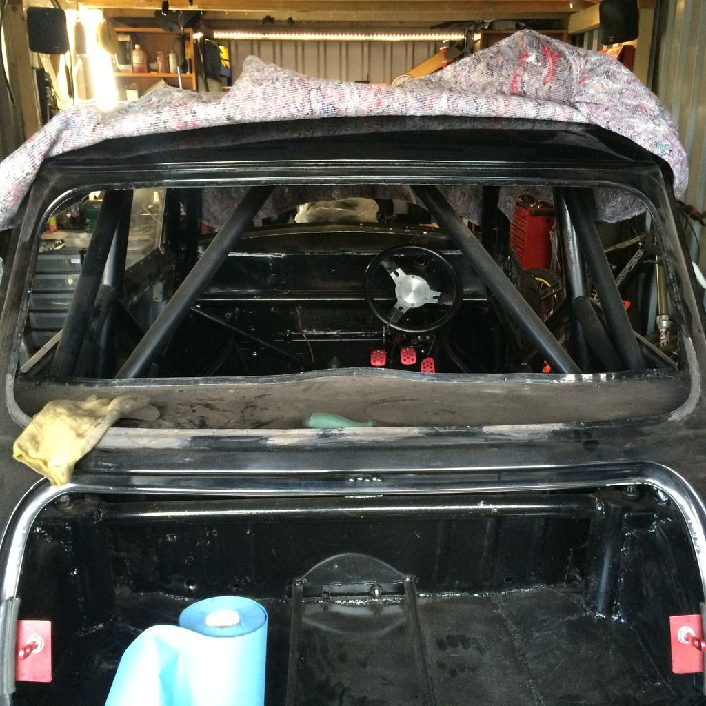

Fitting one might be more of a pain than I was thinking about. As my rear diagonals are an inverted V meeting a V in the roof.
Can't use the rear seat back as I have no strength in it. Arse.

Shoulder belts should be crossed when the anchor points are more than 500mm [20] behind the seatback.
As with most things it pays to keep reading. And I have not got further than that bit yet.
Cheers for the link some good reading. Now of to the shed to take some measurements.

Yep going to have to be a full width bar. But at what height I will have to wait till I get the seat back in. At least one of the cross bars will help locate the harness.
5D4C9A58-88DE-4A73-A55B-B3F19485A6A3_zps
Now I wonder where my notching tool is?
