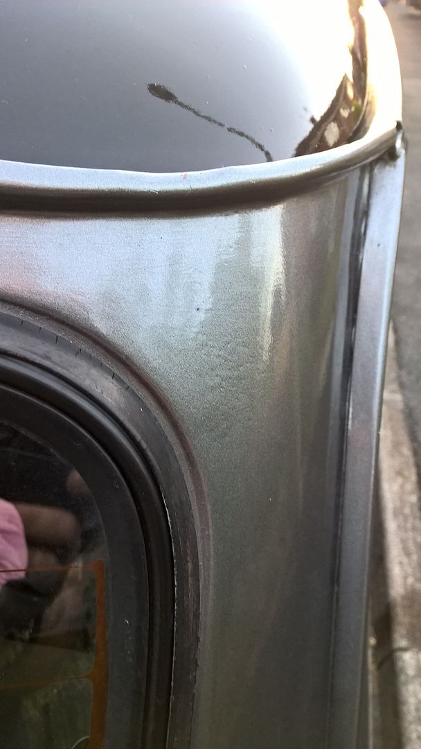

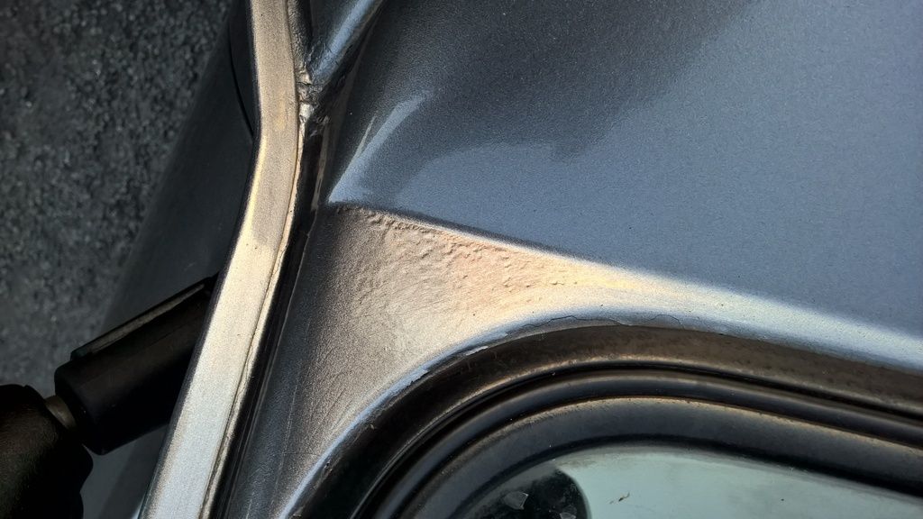

Posted 19 July 2015 - 08:40 PM
Hi Guys, thanks for your advice so far, here are some pictures to show the state of the paint job:
The whole car isn't this bad, its just around detail spots like windows and the roof join.
So what's best to sort these problem areas out? Not sure what paint it is, but its described as a Metallic Gun metal grey.
Thanks again guys

Posted 19 July 2015 - 11:00 PM
Unfortunately, the areas you show in your pictures all have imperfections under the top coat due to poor or rushed prep.
There is very little you can do without rubbing it back and painting it again, although i would say flatting and polishing may improve the finish but not by much.
