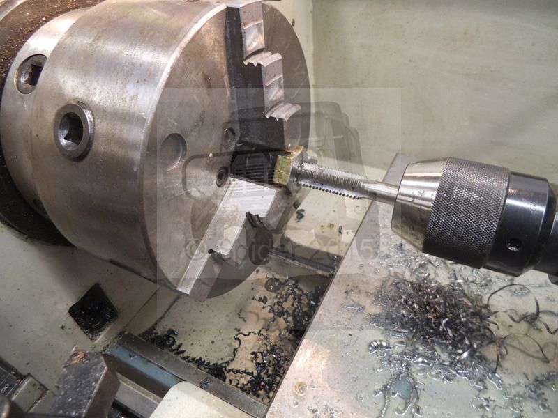

Bobby, maybe this might help give you a better picture?
The hollow M20 bolt is screwed and loctited in to the Gearbox, theoretically never to be removed again, then a stock Sump Plug is fitted in to the hollow bolt.
Then, every time you change the oil, instead of taking some of the Gearbox Case away with the removal of the Plug, it's steel on steel, so dosen't bugger up.

I make them, but I don't do them in any commercial way. Just find an engineering shop (or a mate who's handy with a lathe) and have them drill & tap an M20 bolt, maybe slim the head down too.
