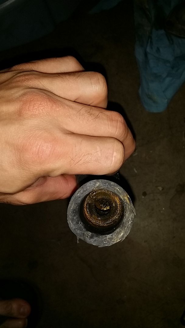

Thanks for all the quick help. Here is a picture of the restrictor in the upper hose.
Seemed a little strange to be in there, especially with no thermostat.

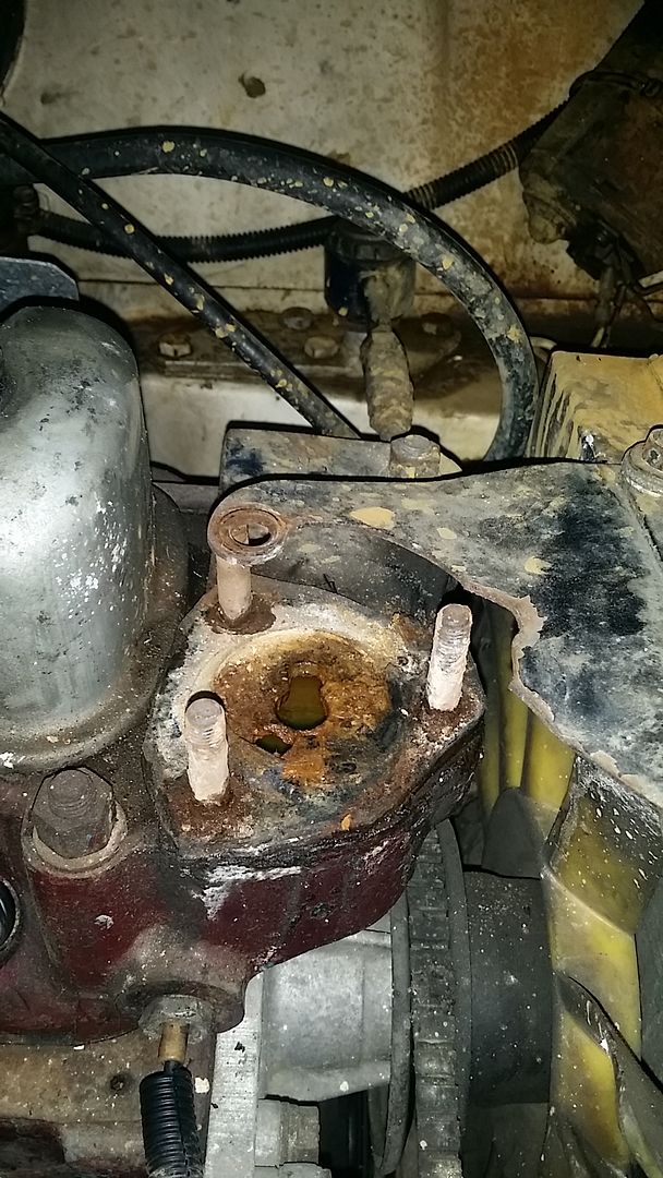

Here is where im more concerned about. This is under the thermostat housing. Is this really how the engine mount is supposed to look. It seems extremely restrictive.

It looks like someone made an extra heavy duty engine steady bar And in the process removed the tstat. I think I will try removing the bracket and putting in what I believe to be the oem configuration.

Many thanks for the photo!  A picture does tell a thousand words and this one doesn't fail.
OK, looks to me like someone has pour LOTs of something like STOP LEAK in to the cooling system and that's your likely suspect here, and in any case, will have to be cleaned out. I'd suggest having the radiator professionally done and for that matter, the block too if you can get the car to a cooling specialist. I doubt even CLR would help there.
There is presently no thermostat fitted, that's just GUNK!
It also appears from the little I can see that it is not the original engine and may in fact be from a later car, these had complete power units imported from the UK. A bit of a give away is the head stud / nut and the appearance of the small bit of the block I can see, though this is far from conclusive. If it is the original engine, it's had a bit of work done, the head has been off at some point, the water pump is not original (but I wouldn't expect to find an original on there after all this time!), the fan has been changed out for a later one. The head I suspect is the original Deluxe one, but again, I'm not 100% certain of that.
Hard to tell for sure, but the radiator does appear to be the original, these were the same as the Cooper S ones and were a very good high quality radiator, you won't get anything like the quality of that today. I'd be inclined to say if it's serviceable, hang on to it. I see that the top radiator steady has one of it's ears broken off too.
The engine steady is not standard on this model and I suspect (again) that while originally it would have had a 3 Synchro, remote change style gearbox, it now has a Rod Shift box, consistent with the later import (to Aust) UK Power Units.

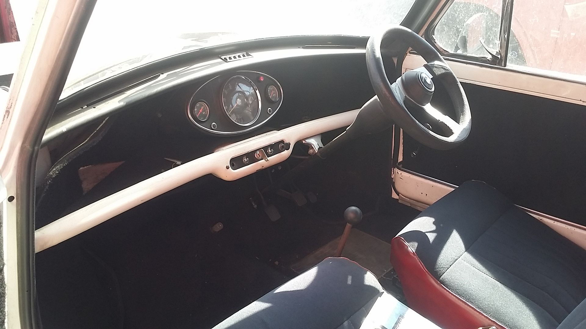

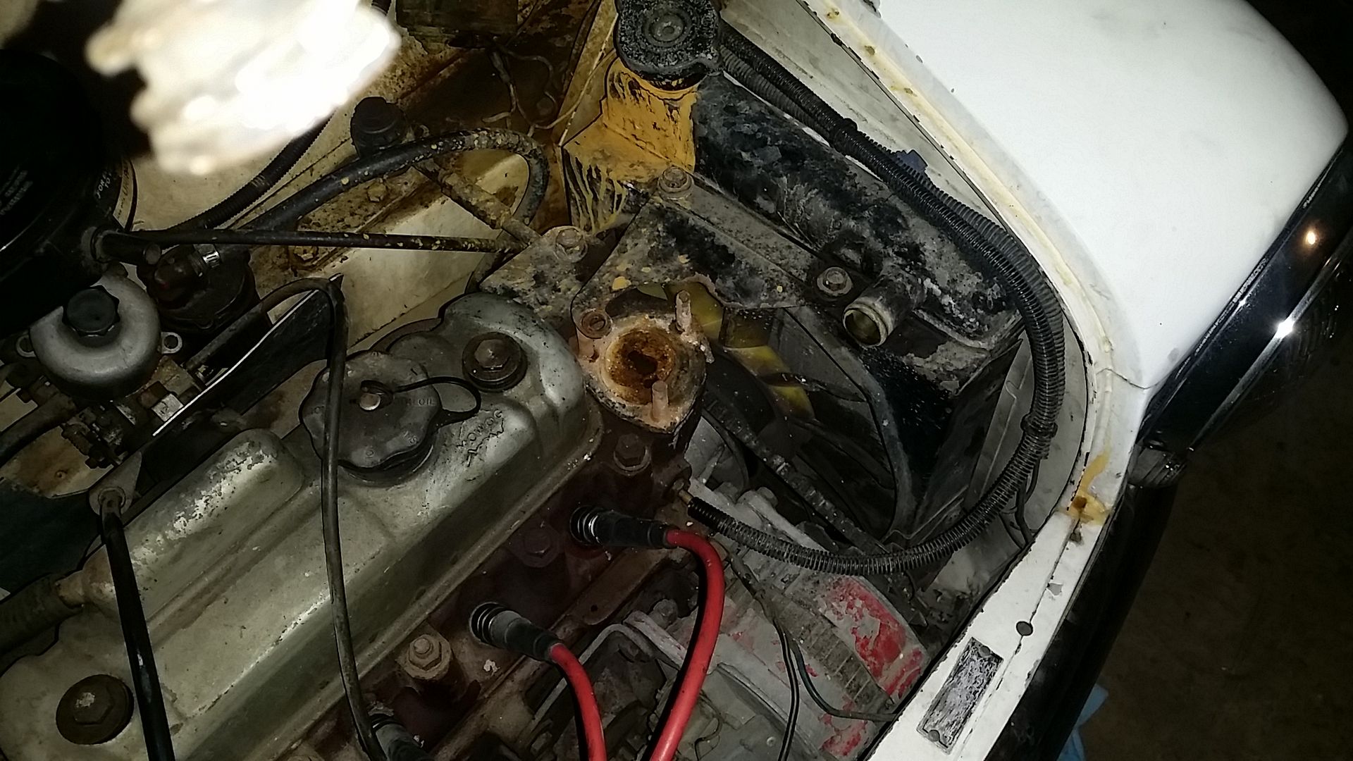

Posted 14 August 2015 - 09:43 PM

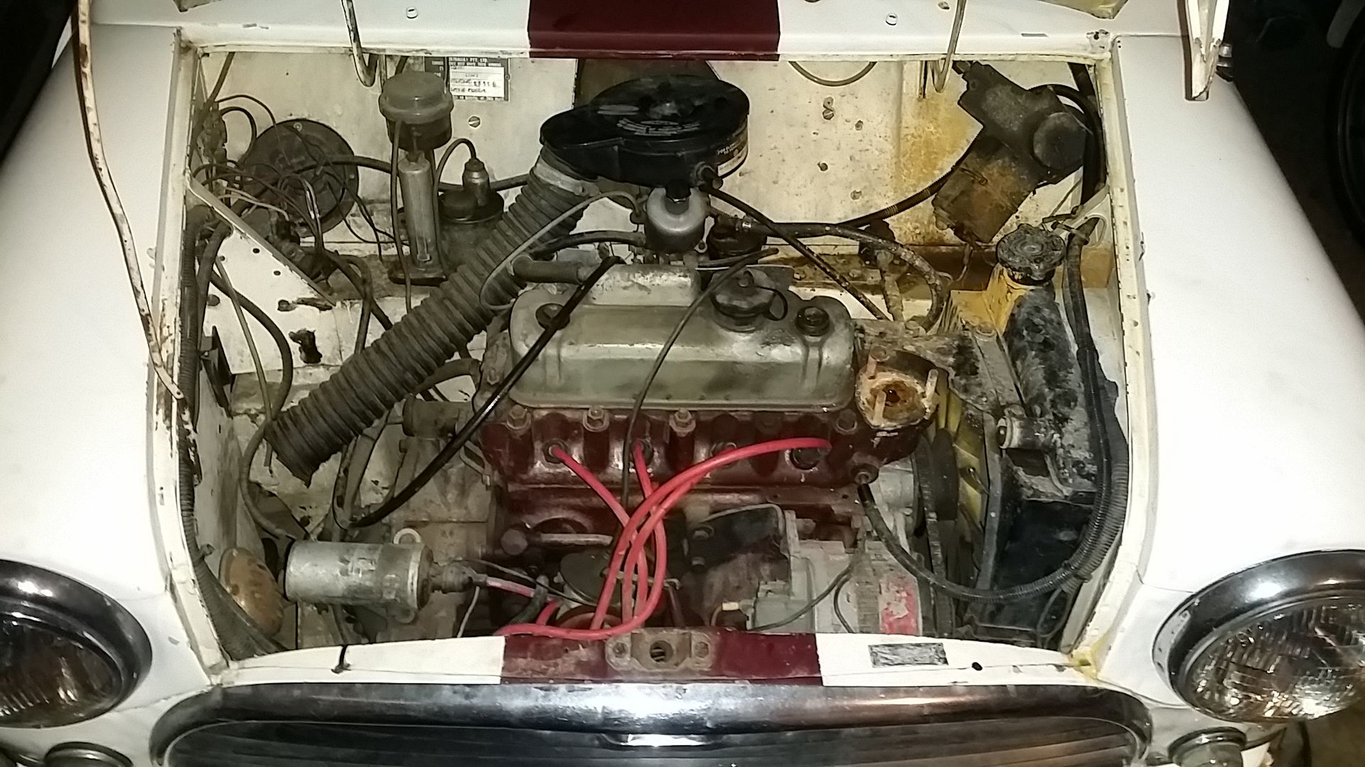

I didnt realize I hadnt uploaded the pictures to this thread. I am still trying to figure out exactly whats fitted to my car, so any information you can give me will be fantastic.
I already ordered a new thermostat housing, thermostat, upper Radiator bracket upper and lower hoses, water pump. bypass hose, and radiator cap just in case. Figured it wouldnt hurt. My plan it to have the radiator flushed, then modify the old hoses to be able to flush the block as best I can without taking it out, then replace the hoses. Im going to remove the engine brace so that I can put a thermostat back into it. Then later on I will order a regular style one if need be. Here are some more pictures.
#14 Spider
Spider
  • 15,063 posts
  • Location: NSW
Posted 14 August 2015 - 10:25 PM
Basically a nice car!  Little bit of a bitsa in there, nothing to be alarmed about though. I am fairly sure now I see that that the engine is of UK origins, it has an alternator (which isn't a bad thing at all) and a Speedo Binnacle from a Mini K I suspect. The suspension has been converted over to Dry, the Hydro is nice, but given where you are I don't know if you've any service agents nearby if you ever needed to have it pumped up (or the like), so I'd say being on Dry is a good thing, and it's really a good suspension system in itself. I can see from the Body Plate that it was indeed originally a Mini Deluxe (as you've said). It appears to have the original (to the Deluxe) HS2 Carb, though the UK engine would have had a HS4. When you get the cooling issues sorted, it might be a good idea to just check what needle is in the carb.
Be interested to see a photo, underneath and from the back of the engine, so we can see what sort of gearbox you have. For now, I'd suggest leaving that additional engine steady in place until we see your gearbox. The original Remote Shift Gear box, used the Remote as an engine steady, if it's been swapped over to the later Rod Shift, you'll need that added engine steady.
In regards to having the cooling jacket of the block and head cleaned, a cooling specialist should be able to do this for you, with the engine in car, it may not end up 100% but will be a shed load better than it is now.

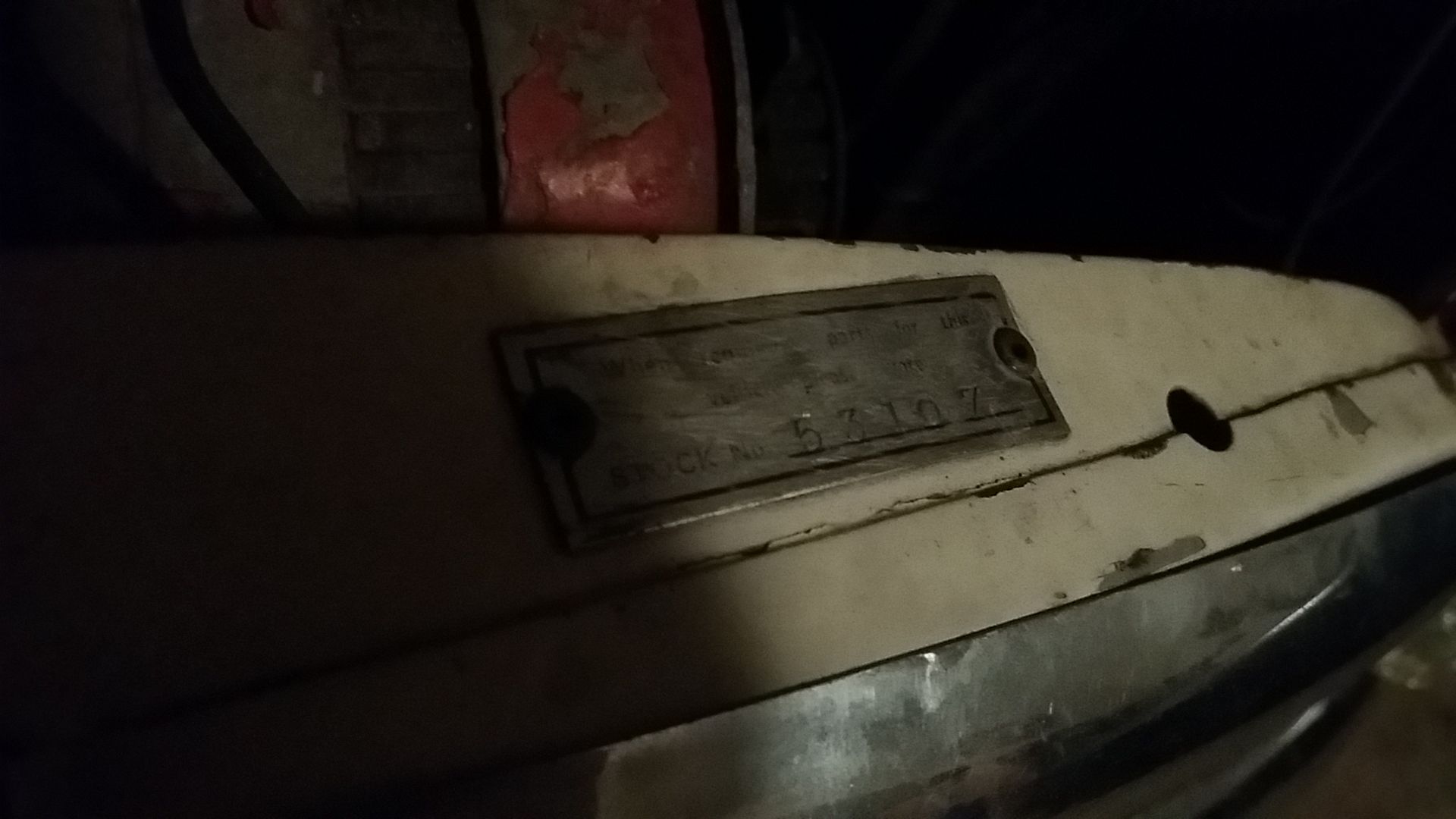

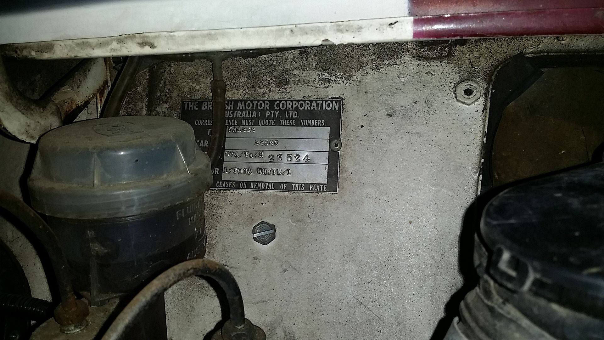

I can see a label of some sort on the Bonnet Closing Panel, just in front of the Alternator, could I trouble you for a photo of that?
#15 Darthteddy
Darthteddy
  • 21 posts
  • Location: Ontario, California
Posted 14 August 2015 - 10:29 PM
Heres the front plate. How can I be sure if the engines been swapped? I looked for a vin on it but didnt see one. Ill get pictures from underneath in a few.
