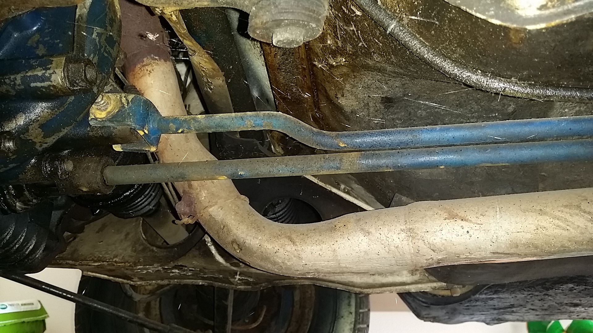

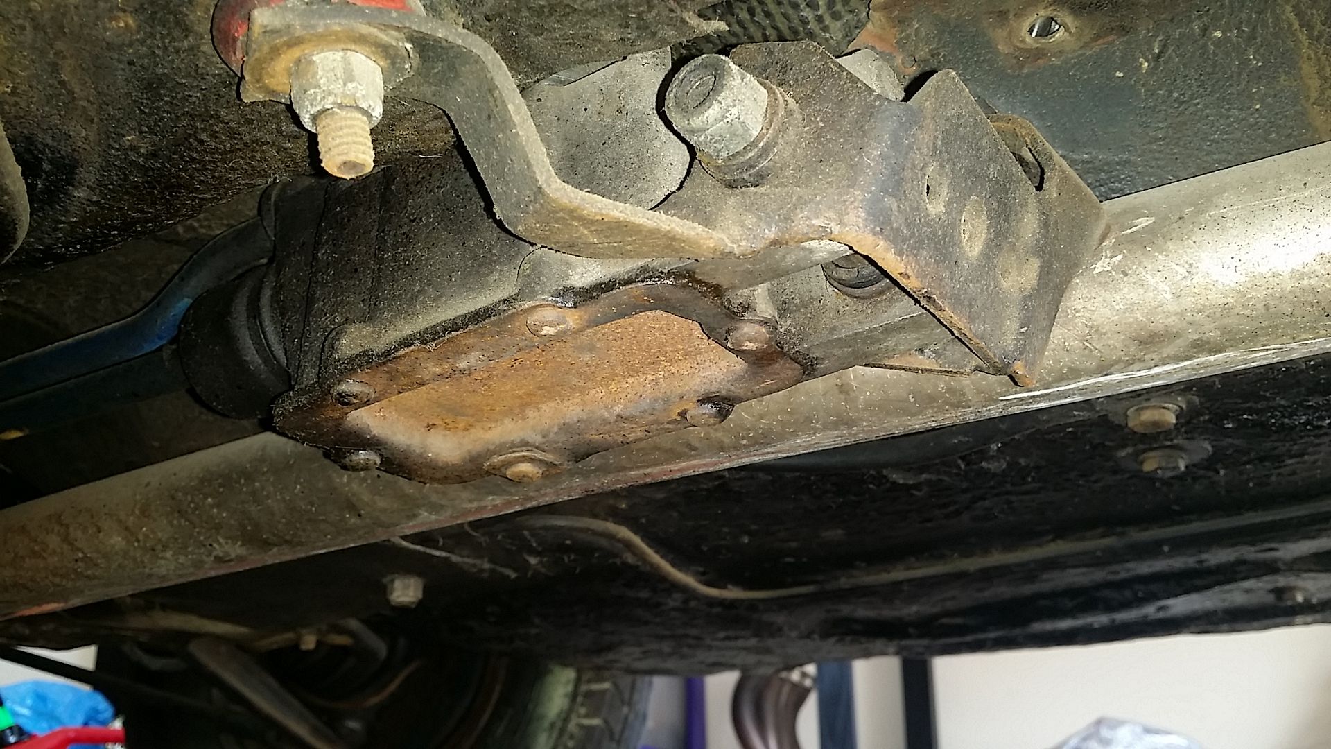

OK Cheers. Yeap a Rod shift type Gearbox. You'll need to retain that top steady.
That is also not original, but in so many ways, better in any case, not the least of which is Synchromesh on 1st Gear.
Also appears to have a lower steady fitted. I haven't had much to do with these, but was looking at one the other day. They are a bit of a poor design. We never had these on any Aust made car, so a bit of a rareity in these parts.

Im going to have to order a new upper steady bar set up. The current one is wayyyyyy to restrictive. Any recommendations for an aforable one?

Posted 15 August 2015 - 03:11 AM
The Original Aust ones were all pretty much the same, only there were 998 / 1100 ones and then we had 1275 ones, only none of these were adjustable as yours appears to be. They never fitted these in the UK (as far as I know), it appears they relied on the lower ones only.
Have a look at DSN Classics, they have a slightly different one.
However, before you do that, in what way do you find yours restrictive?  Maybe I'm just used to them being there, but I don't find them restrictive. One tip I will also add though is to loose the studs and fit bolts (should be 5/16" UNC), that will make life somewhat easier I suspect. Whether you stay with the studs or swap over to bolts, I'd suggest always making a point of greasing them before fitting the Thermostat housing, just to avoid corrosion.

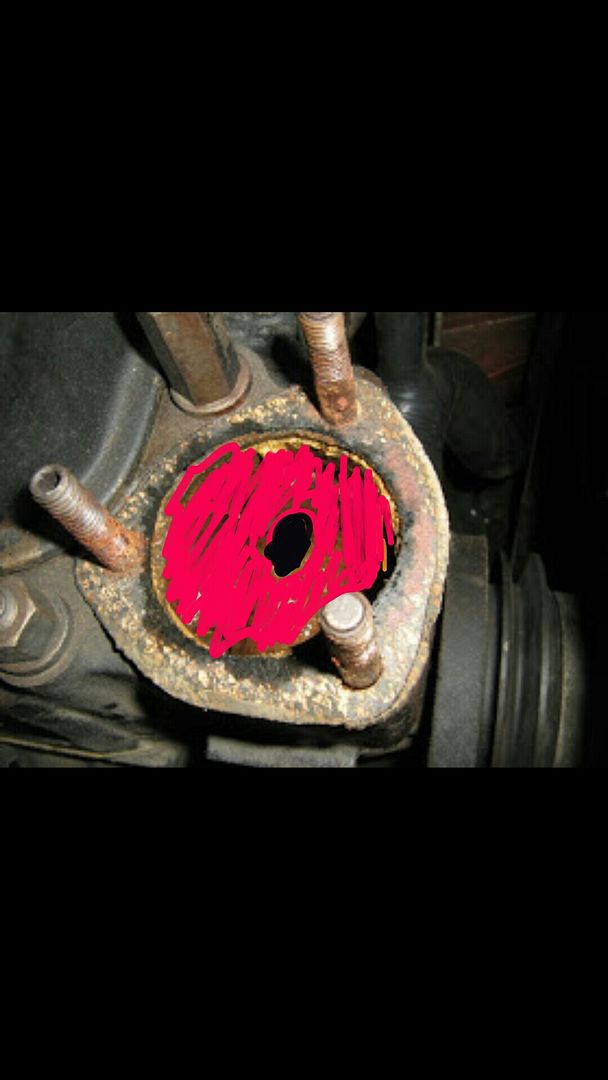

Posted 15 August 2015 - 04:25 AM
The quarter inch or so keyhole in the middle of the plate is the only place for the coolant to flow, and it makes it impossible to install a thermostat. So instead of the 2" diameter hole minus the thermostat center, the coolant can only flow through that little keyhole. Surely that is not enough.
So instead of this
Coolant can only flow like this(in the black area)

Posted 15 August 2015 - 05:05 AM
Ah, OK, got ya now.
I've just gone back to the photo where that was still fitted to the engine and it looked to be junk in the coolant, but now you've pointed out, it's a solid plate with a small hole drilled / punched in it.
OK, it should look like this one;-
http://minisport.com...000-1100cc-head
But you could cut yours out with a hole saw on a drill press.
