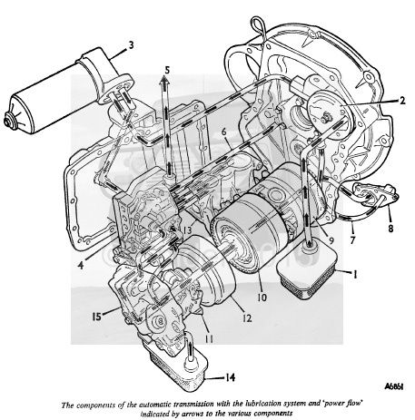

Regarding the mini engine, why can't the pick up be 'replumbed' towards the back of engine.
#19 Spider
Spider
  • 15,142 posts
  • Location: NSW
Posted 25 August 2015 - 10:25 AM
On an auto (as per the opening post) they already are down the back, (unless on the later models they moved them up front?);-
Every Auto Box I've stripped, the Main Oil Pick Up is down the back, next to and under the diff.

Cool. Mini engine back in the frame! Thanks for the picture.
Thought about bike engine (ride a Honda CG125+Ducati996) but there is the expense of a bespoke diff (quade is really pricey), plus the reverse issue to sort (electric motor seems only sensible option, because of the space I would want the engine to be in backwards ideally which further complicates. Would be cheap for the bits though.
As it looks as though the oil pick up is in the rear then angling it back shouldn't give an issue, next question is what is the difference on the front of an automatic to the front of a manual engine? anything extra sticking out that cant be relocated?
