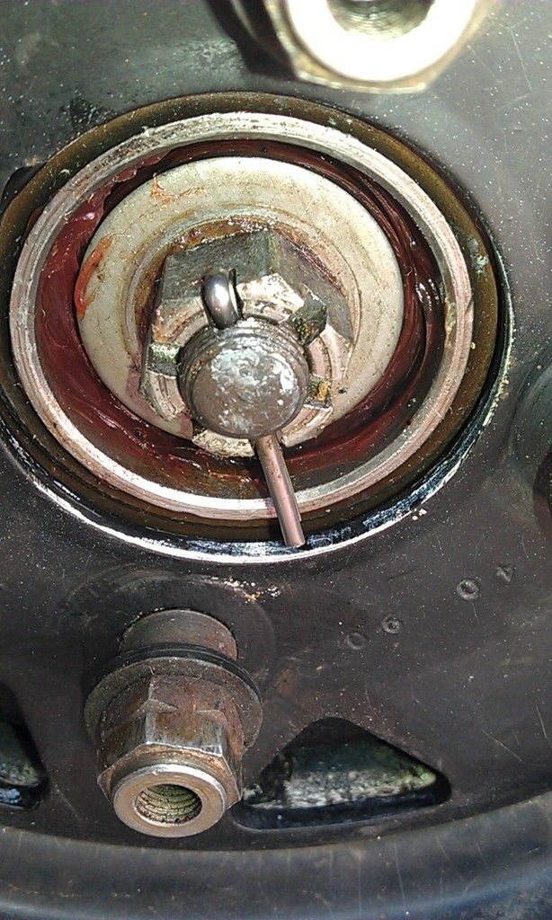

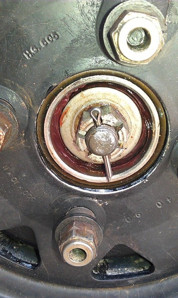

Silly question time, I borrowed a Tork Wrench and have just tweeked my Rear Hub Nuts (60lb ft).
Manual says to torque to nearest split pin hole, I had to slight slacken one off to achieve this - is that OK?
The Torque Wrench was kind of acting up on one side where it tightens to the left the Torque Wrench would not click off, when I went to undo it then it clicked so it was probably over tightened??
Last question, (silly question time) which way around are the pins supposed to go, like this, so that the pin pulls out:
Or like this, so the pin legs wrap around the circumference of the nut:

1. Don't loosen the nut off, tighten it to the next hole.
2. I do the split pin the first way and bend it over the top.

Doing the split pin either way makes no difference to be honest, just one way is more awkward than the other to do.
