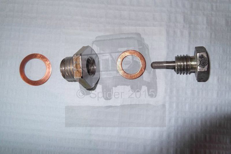

#13 Spider
Spider
  • 15,674 posts
  • Location: NSW
Posted 12 September 2015 - 09:47 PM
to see how tight access is, try and get a socket on the sump plug while it's attached to a 12" extension bar. Then imagine trying to get drill bit and drill square.
Is it worth getting a tapping sump plug from minispares? Been reading up on them and not sure if it's the best idea! I just need a quick fix for now as I got a show next week and haven't got time to mess about with it!
GW is right that access is tight, however the guys that have fitted up that repair insert of mine in situ, remove the tie bar. It's not going to make it dead easy, but does help.
