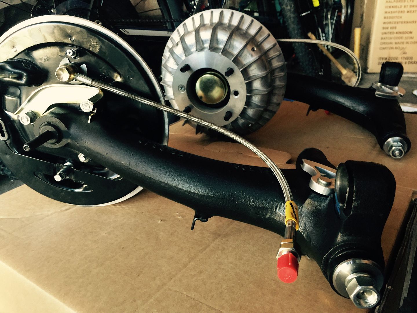

I believe there is a later version (see the link). The brackets are not required because there is nowhere to mount them on the back plates.

Aren't the mounted on the radius arm to backplate bolts like this?

There is no later version. You need the (silver) bracket that locates with 2 of the 3 backplate bolts as shown in the above photo.

ok - so I stand corrected. I shall add them this weekend.

Posted 02 November 2015 - 11:40 AM
One of these:
http://www.minispare...assic/handbrake bracket.aspx|Back to search
and one of these:
http://www.minispare...A1670.aspx|Back to
You can probably get them secondhand for peanuts.

Thanks. I do have them off the original ones but I bought whole new drums hence my confusion
