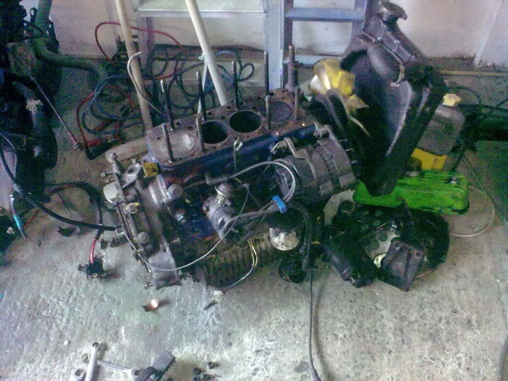

Also lest month some idiot ran a red light and took the front of my daily drive, leaving me with *melonsed* thumb and a bad neck, so iv not been able to do much for the last few weeks, however it did mean that insurance have paid me out a nice wedge, so with that money i decided to put the spark back into snot by deciding to go down the turbo route!!!

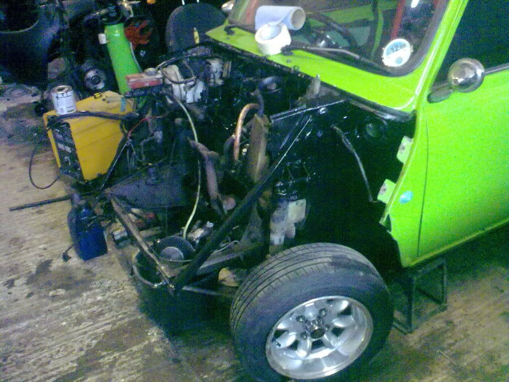

Last week i started feeling a bit better and whipped the engine out of Snot leaving my mini looking very sorry for itself ;)

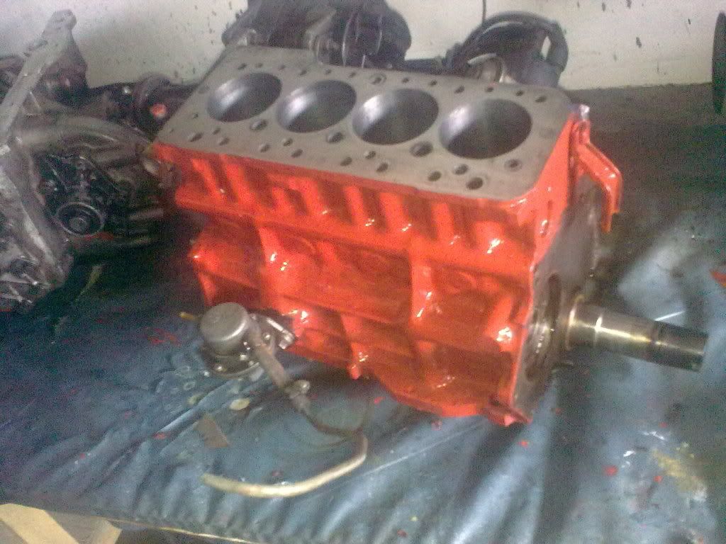

I decided that if im going to stick a turbo on the engine i should give it a nice re-build before hand even though it was a strong engine. So i started stripping it down.
Then left with the block i de-glazed the bores and cleaned up the face, and gave it an instant 100bhp by painting it red haha.

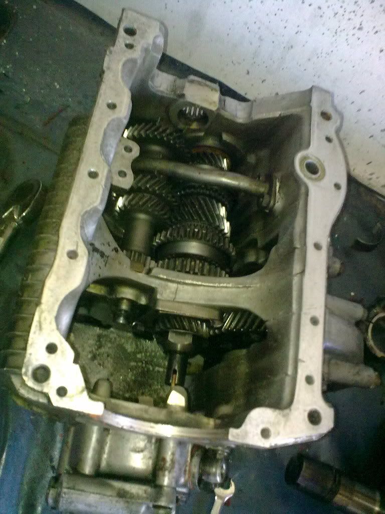

Iv also stripped down the gearbox, which seemed to be in amazing condition. So iv just built it back up, fitted a central oil pick up and a 2.9 final drive, but before i fit the engine i think ill take the diff back out and fit a x pin diff.

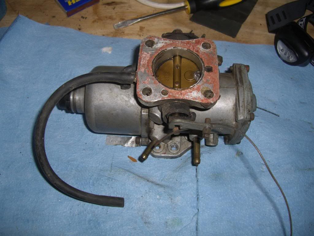

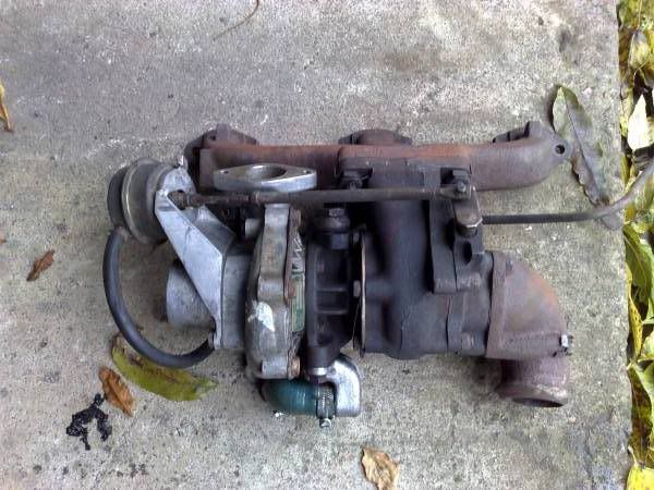

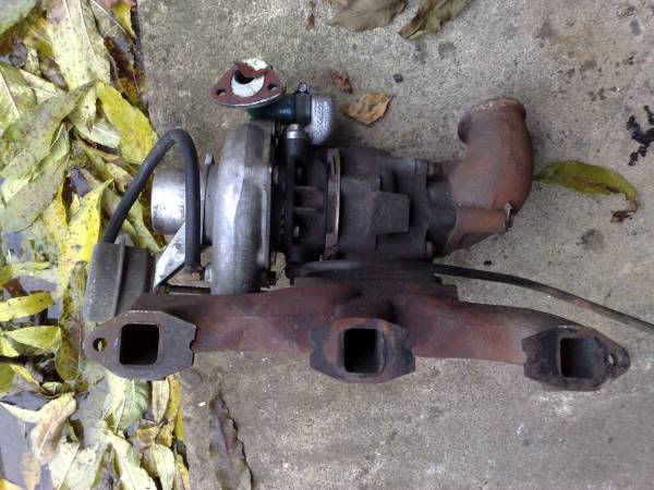

First up the turbo, on its manifold along with a few other usefull bits, from jayare off the forum :thumbsup:

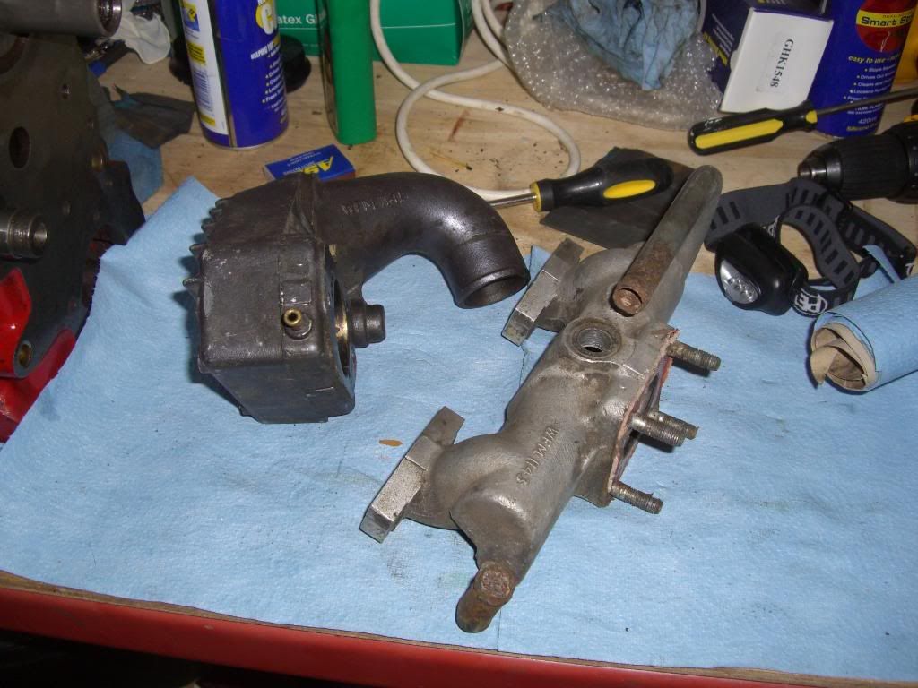

Iv also managed to source a turbo inlet manifold and plenum:
Along with a turbo HIF44 carb:

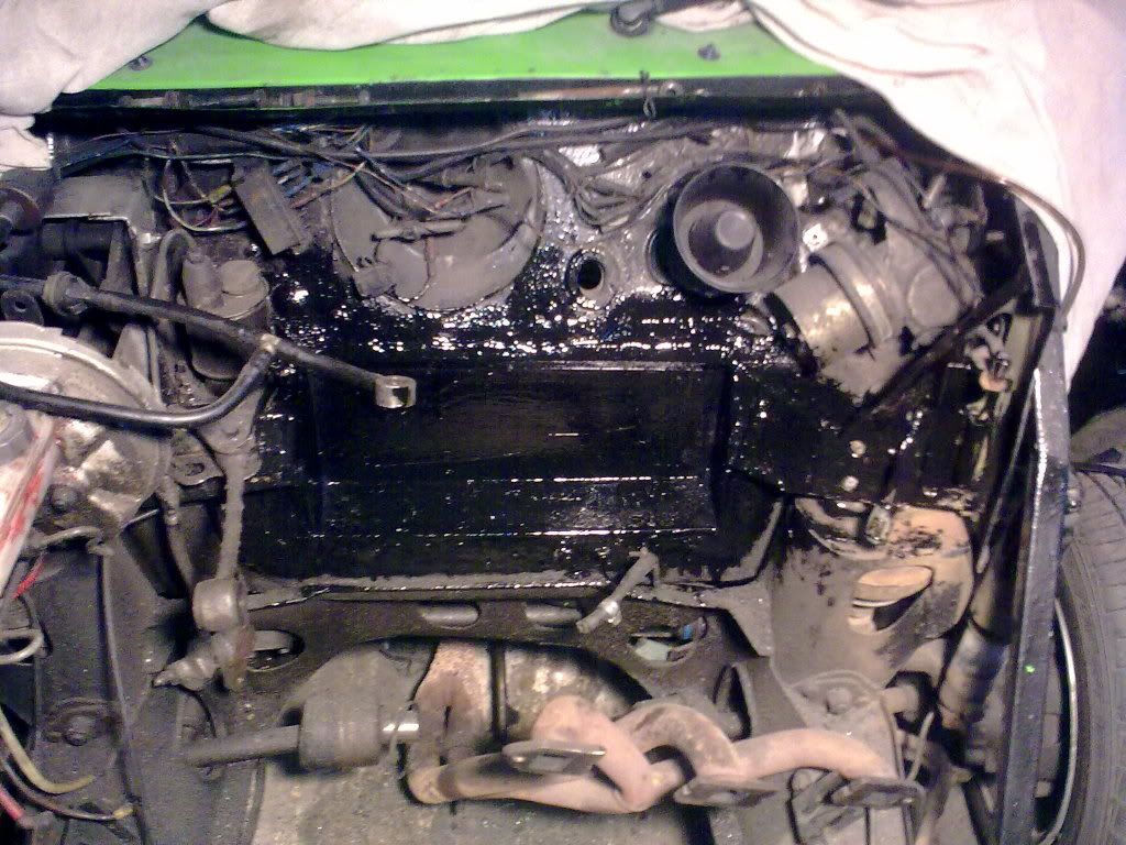

Another little update, i brought a bulkhead box off Jason G from on turbo minis which was made very well and was just £19 posted, if you need one i would definitely recommend him!!!
So as i had the bulkhead box i though what the hell ill get it fitted, i decided to do this whilst down the unit, so had no pictures to go off to see exactly where it goes in the bulkhead so i just guessed on its position and got cutting and welding and heres the result:
I checked against the pictures i had saved on my laptop and luckily its exactly in the right place :( so much have been pretty easy to fit haha.

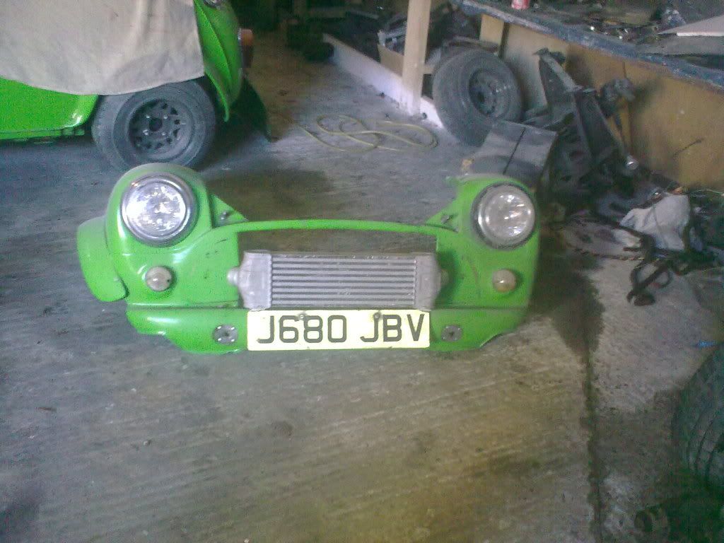

Not much done with the turbo conversion atm, as im thinking of getting the block over bored, buying some nice pistons and getting my crank sorted so i can build a stronger engine, so i can run more boost :D
