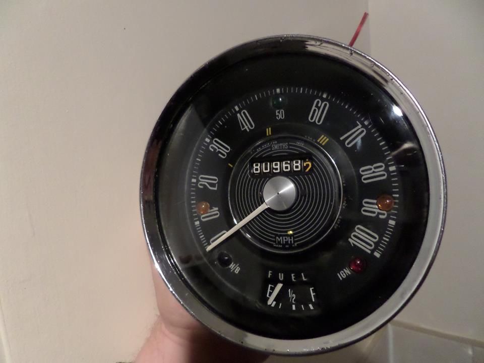

Hello, this is my first post, please be gentle..
I am not new to minis and have owned them since I was 13, (22 years ago?!)   I like to think I know a bit, but....
I have a speedo in my garage and I just cannot work out its origin.
The speed is fairly simple, its a 100mph speedo, so only 997 (I believe the 998 went to 105?)
I have seen plenty of these 100mph speedos, but this one has the amber warning lights at 10mph and 90mph.
I also thought the 997 never had the extra digit on the mileage.
I have stripped it and its not a copy and due to the pressings the warning lamps must be factory.
Maybe there was a short period when this was produced?
Maybe a police conversion?
Or even a production test, as the later 105 mph speedo allowed the lamps to miss the printed numbers where this does not?
Thanks for any help, I have lurked here a good while, and some people here really know their onions!
Here is a picture-
12571164_10153973331889673_1619516052_n.

That is interesting, and a good point about the indicator warning, when I say the 105mph I was meaning this type-
(I think the did this so the warning lamps missed the digits) I think this would be a 998..
Which makes my one a bit odd.

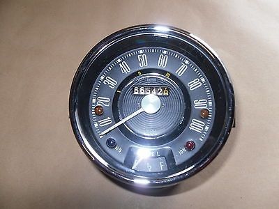

I've never seen one with the amber lights coming through the numbers like that before. Is it possible you have an inner from a Morris Minor and the outside from a different car?
This one on eBay has the same number 4419/00 and 1472 tpm. This TPM wasn't fitted to minis as far as I can see, it was fitted to Minors though...
http://www.ebay.ie/itm/271932752349
Your outer section looks like this one
http://www.ebay.com/...=p2047675.l2557
Edited by timmy850, 22 January 2016 - 04:29 AM.

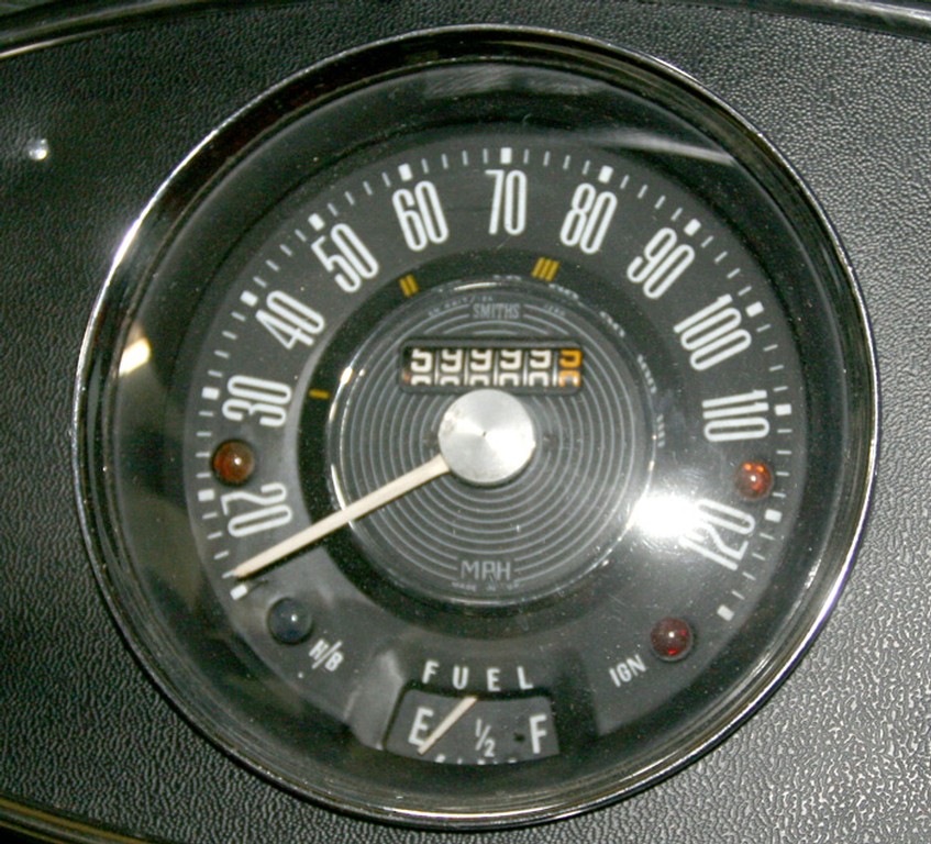

Most Morries had 80 Mph Speedos and some of the later ones had (an ambitious!) 90 mph face, but I'm fairly sure they didn't fit 95's to them!
If you scroll down the page here;-
http://new.minimania...Cooper_S_speedo
You'll see a Cooper S Speedo of the same era, with the Indicator Lights in the Speedo. My late (Aust) MKI Cooper S was like this.
The 1472 tpm was used in the 1071 and 1275 (UK) Cooper S that was fitted with the 'Optional' 3.9:1 FD, however, I can't see it on any listing for a Morry.

It still looks like two separate pieces. I'm happy to be proven wrong, but I would have thought they'd never put the indicator lights in the numbers, like the one in the first post
Late minor speedo, goes to 95
http://www.mmoc.org....919036486abe0c3
Edited by timmy850, 22 January 2016 - 08:23 AM.

Posted 22 January 2016 - 08:26 AM
Like these?
article-2222510-15A802D5000005DC-715_634

The inner may have been changed, who knows, its 50 years old.. This is not what has me stumped, its the outer face.
The amber lights are factory fitted, and I have never seen one with the numbers interrupted by the lights before.
There doesn't seem to be a pic of one like it anywhere, I think the 105 face introduced later was to prevent the lights/numbers clash.
So I wonder if this is pre production or made for something not mainstream.
*That outer face has not been made for a minor, the green light tells us that and the small 50mph.
