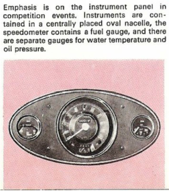

I found this picture in a 998 Cooper Sales Brochure
998%20Cooper%20on%20Hydro%20Inst_zps2vvy
It doesn't have the indicator lights (this was a MKI Model) but it does have the small 50 at the top and is only marked to 100.
Edited by Moke Spider, 24 January 2016 - 08:43 AM.
