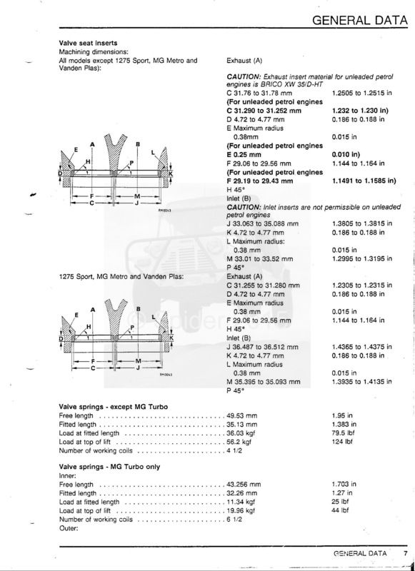

Here's the page from a later (1989) Factory Metro Workshop manual;-
Page%2018%20%20from%20Metro%20factory%20

Okay cheers will have a measure tonight and let you know the outcome.

Inspected and measured springs last night .bang on 52 mm all of em all straight no issues so gonna re-use them.thanks for all the advice.
