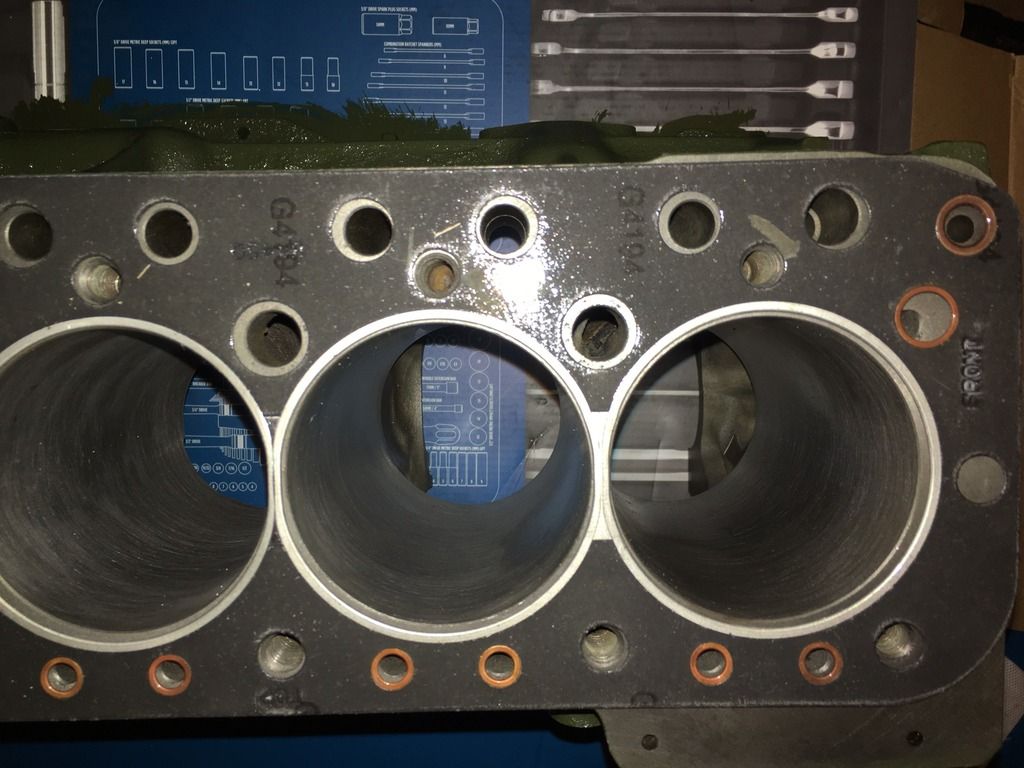

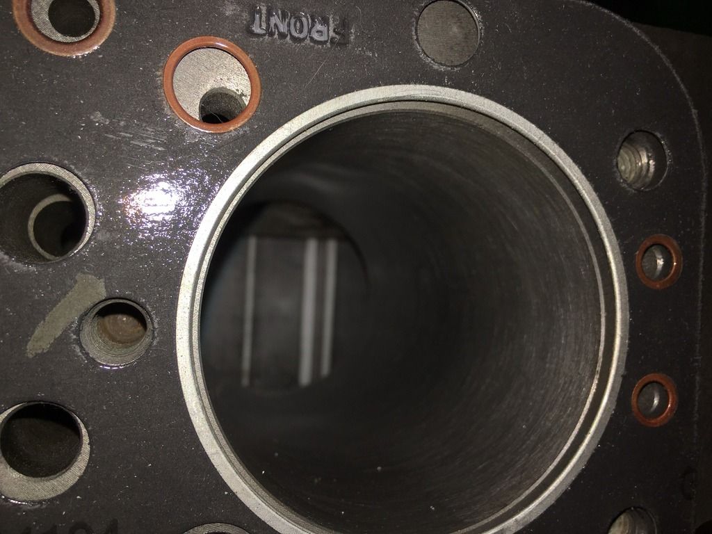

Just wondering if anyone else has experienced this problem with a head gasket, or whether it is a problem at all?
I've just had my block back after being machined. It's an ex MG Metro A+, and has been rebored to 1330. I offered up the BK450 gasket that came with my mini spares head gasket kit, just out of curiosity, and noticed that one of the waterways doesn't line up with the gasket. The copper ring actually covers part of the hole. It's the hole next to the 'Front' stamp. Dodgy gasket? Me worrying too much? Don't want to blow the head gasket on my first full engine rebuild!
As always, all help is massively appreciated :)

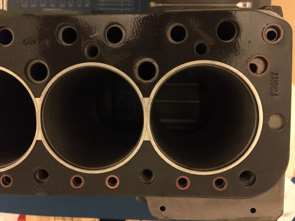

How strange! Have flipped it and it's the same. All the other holes line up perfectly, just this one partially covered. The gasket came from a mini spares head gasket kit:
http://www.minispare...ic/AJM1140.aspx
Reckon I'm best off trying for another one from a different retailer in case there's been a bad batch, or looking for an alternative?

Situation is that I compared it to a BK450 bought from another supplier and the two were absolutely identical.
I then ordered an AF470 (Minispares part GUG702560HG) and again the hole locations are absolutely identical.  In fact, the only difference I could see was that an oilway has a rubber seal instead of copper.
Minispares' response was that 'often the gaskets overlap some of those holes'.  I didn't get a reply after sending the photos.
I also had a chat with a friend of my dad's who runs a 1275 historic rally car who had also had experience of that hole not quite lining up before, but hadn't encountered any problems, so I'm going with the 'suck it and see' approach.  I'm going to keep a very close eye on it once the engine is finally in the car.  Unfortunately it's looking like another couple of months before I'm going to get a chance to start it up and see what's what.

Just a thought. If you turn the head upside down how does the gasket look in terms of alignment? If the gasket is off centre with the block will the oil still flow through to the head or does the overlap affect the oil transfer from block to head?
