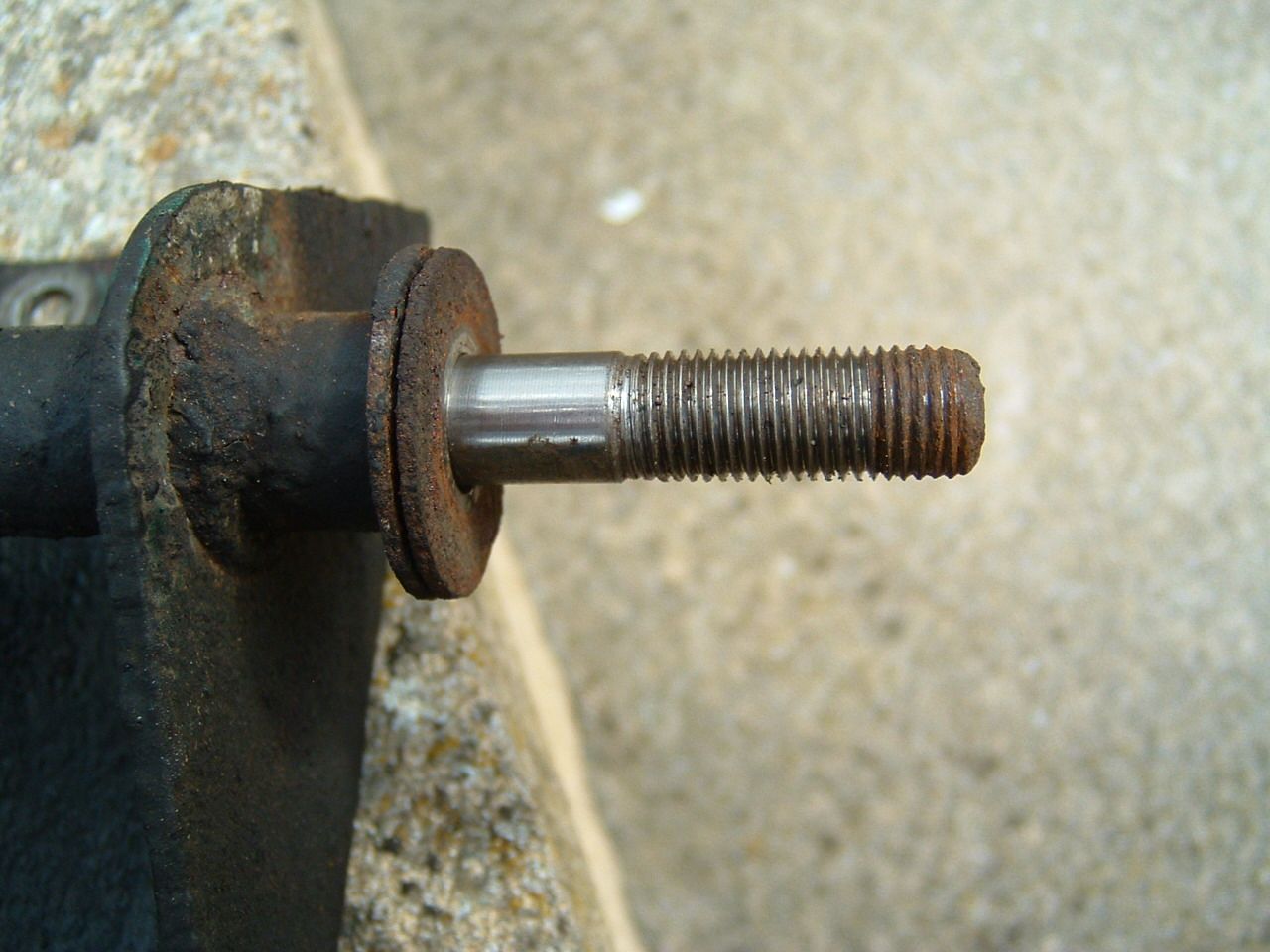

Just in the process of cleaning up the front upper shock absorber mounts.
The end of the thread of the captive bolt is rusty.
Managed to get the old nut off with some difficulty but the new nut won't go on.
I thought about getting a die chaser but what size and pitch thread will it be?
Alternatively, has any one got any tips on cleaning what is only about 5mm on the end.
Regards
Mike.

The 'Pin' over which you slide the shocker eye?
3/8" UNF.

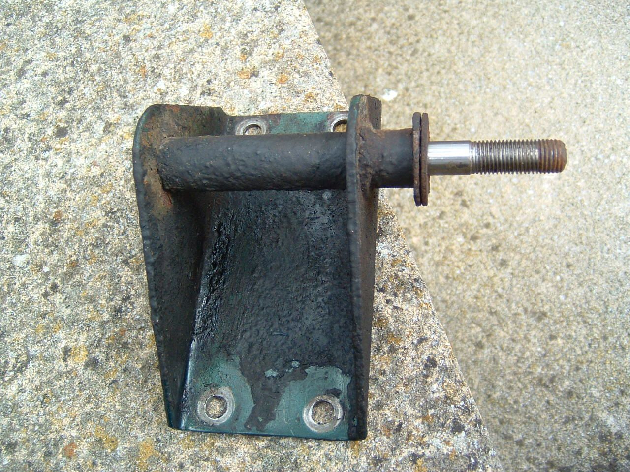

#12 MikeRotherham
MikeRotherham
  • 987 posts
  • Location: Westwoodside North Lincs
Posted 31 August 2016 - 12:55 PM
Thanks for all your prompt replies.
It is the pin that the top of the shock slides on.
I've added a couple of pics to show the problem.
I think the bolt is welded so I would imagine I'd need to replace the whole mount as I don't have the equipment to reweld.
Edited by MikeRotherham, 31 August 2016 - 12:59 PM.
#13 Swift_General
Swift_General
  • 871 posts
  • Location: England
Posted 31 August 2016 - 02:36 PM
Can you not run a die over the rusty part of the thread?
#14 Mini 360
Mini 360
  • 4,933 posts
  • Location: Aberdeenshire
  • Local Club: Independent
Posted 31 August 2016 - 03:24 PM
Think they are about £10 new, I would just replace them.
#15 nicklouse
nicklouse
  • 18,696 posts
  • Location: Not Yorkshire
Posted 31 August 2016 - 03:44 PM
 a bit more
