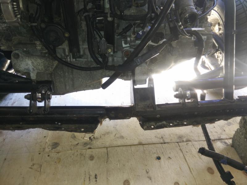

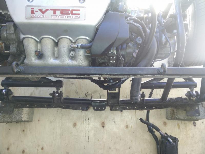

Attached File  IMG_20180203_152222.jpg   75.17K   8 downloads
The engine in the now straightened frame!
Attached File  IMG_20180203_154144.jpg   68.85K   8 downloads
How to install the rear subframe when you have only 2 people and an overkill lift  :shades:
Attached File  IMG_20180203_154204.jpg   45.24K   2 downloads
Attached File  IMG_20180203_171139.jpg   46.68K   3 downloads
It went in quite well.  No doubt will be in and out multiple times but my plan is to do a dry run and get everything in and then take it all apart for paint/cosmetics.
So this is where i'm currently at.  I think my next step will be to get the front subframe in and try and stack the mini on the lift with my other car.
I will do my best to update this build thread more regularly.  The mini is back to being my main focus :)
