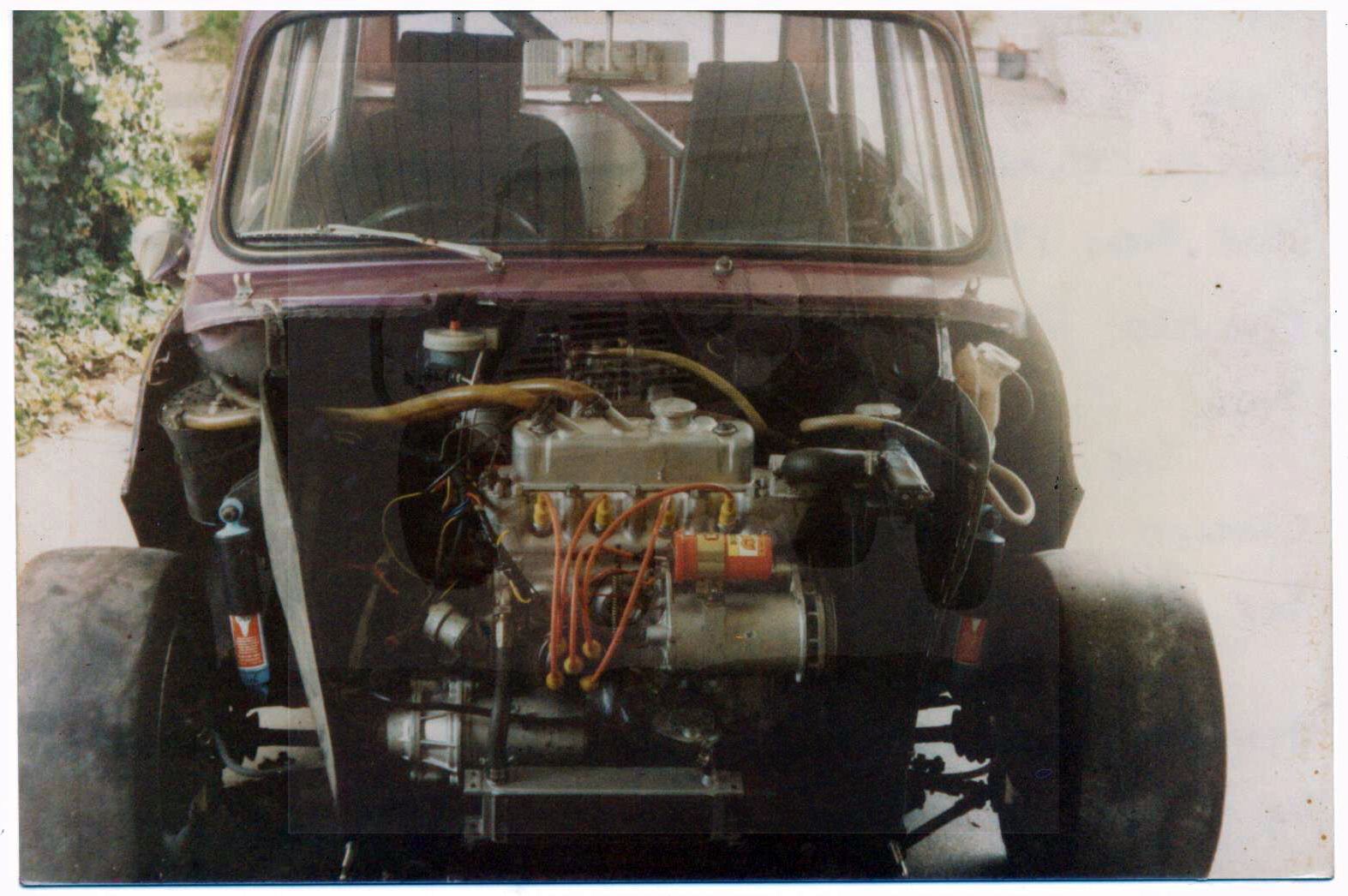

Here's a pic of my Race Car shortly after I bought it (this is back in the early 80's!)
It had two Big Breathers from the Rocker Cover to the Oil Catch Tank. I didn't really understand or appreciate it all at that time and hey, it had an Oil Catch Tank, she'll be sweet!
How wrong was I on that!  First outing resulted in being Black Flagged,,,,,,,,
Only then did I look at what the other guys were doing and looked in to it for myself. Another 3 Breathers went on it and no more issues.
In these set ups, from up top to down below, there, a number of restrictions in the way and so they don't readily breath as much CFM as they need to, so in hind sight, just having them on the Rocker Cover alone was daft considering that the Pressure isn't built up in the Rocker Cover, but the Crankcase, which eventually, via some small flow paths can end up in the Rocker Cover.
But hey, in my defense, not a mistake - a learning experience!
