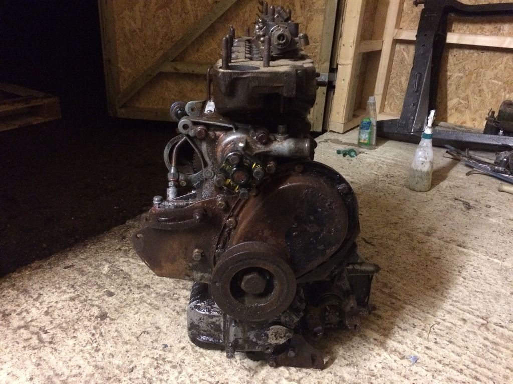

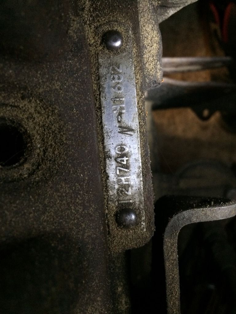

Hi guys got 2 engines with my newest mini project. 1 of which is a 1275 engine but an older pre a+ one. Can anyone decode the engine number to tell me what it's come out of please! Here's a pic
02622C0D-0470-4308-9E00-AA020FC9D39F_zps
Thanks in advance guys !

www.guess-works.com. Go to Technical section and the Engine Number section.

Too old for the Guessworks decoder.
Its just listed as a "1300 transverse type" - nothing special - similar engine spec to Austin/Morris 1300 and/or 1275GT.

I did try the guessworks decoder and couldn't work it out! The engine has the old style driveshaft joints.

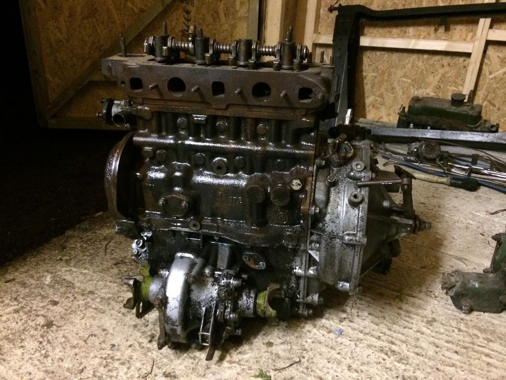

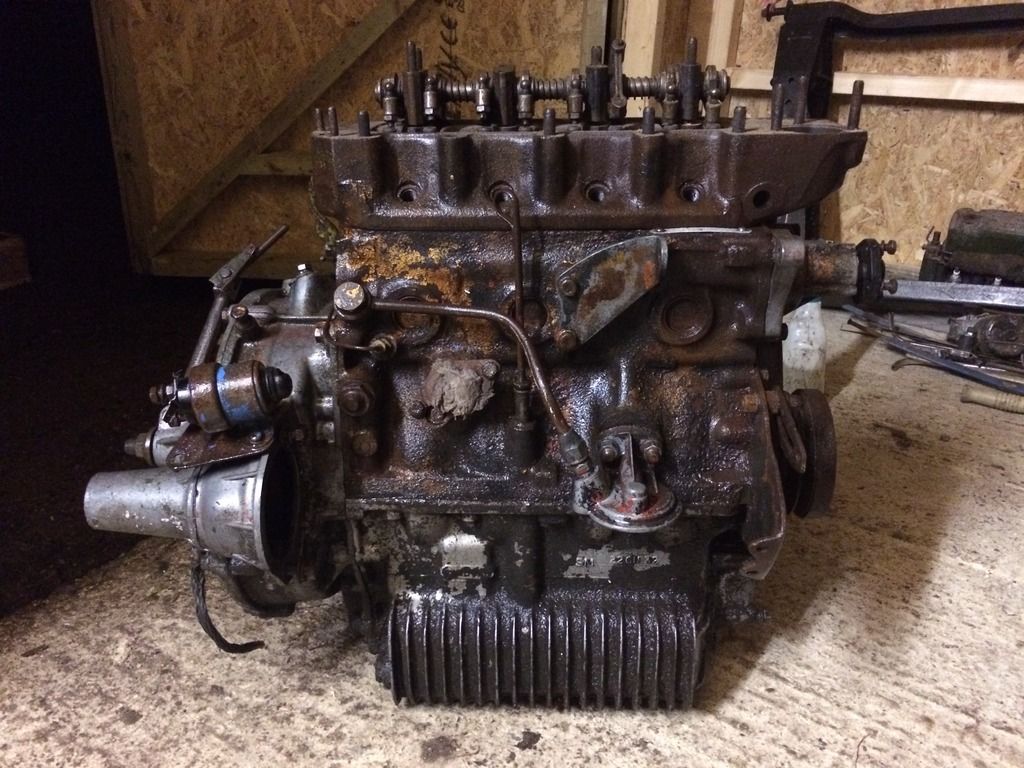

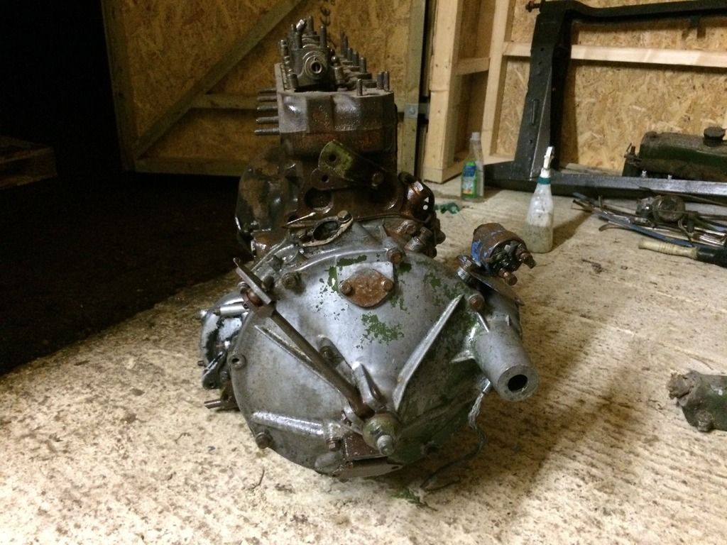

post up some pictures front, top, and rear inc, gear change connection. and we can have a good guess.

Here's some pics !
CE71E264-4CE5-42EA-A29D-AD2BA17DCD22_zps
E8C9D619-FE88-49A3-BF05-C70E3965700C_zps
C0245DC8-B6CE-416A-AFAB-45C40E644C1B_zps
6A4CCB52-BA57-4812-B1AE-1AE15D89B206_zps
I can get more if required!!!

Looks like it has some remnants of the old 'Gold Seal' replacement engine paint on the block?

Yes it does have some gold paint plus gearbox has been painted black clutch cover was green.

Some of those got new engine numbers that didn't tally with anything and I've heard of things like MGBs ending up with Sherpa van engines and other similar things,ah the 70s lol.

right, it is not out of a mini. You can tell by the front plate.

12H740 is not a Goldseal engine code.
The front plate with engine mountings looks typical Austin/Morris 1300.
Rod change box with rubber couplings was a relatively short lived spec.

'73 I believe when the rod box/rubber coupling changeover was.
