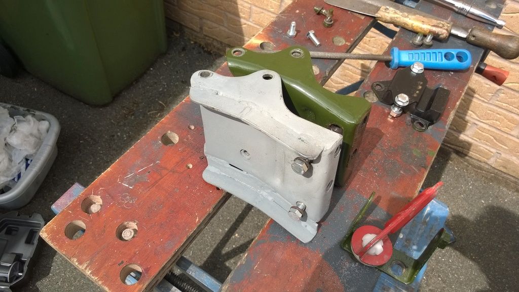

Modify bottom mount for fanbelt removal

Yeah, I'm going to be buying another MED one for my other build this weekend, and as above, will be filing the engine mount to allow an easier fitment :)

You need to modify the bottom mount for fan belt removal for the KAD one too!

If you do modify the bottom bracket for extra clearance its advisable to weld some strengthening plates onto the back of it.
