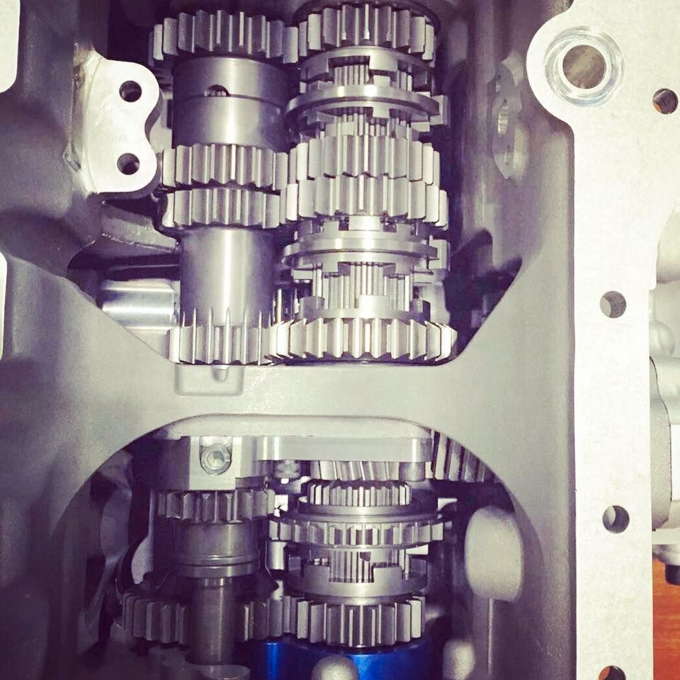

There's a guy in our local club building a sequential 6 speed dog box in a Mini housing. The thread is in Dutch but for those so inclined they can enjoy the pretty pictures https://www.miniseve...hp?f=39&t=56095
There seem to be at least two different gearboxes in the photos.
