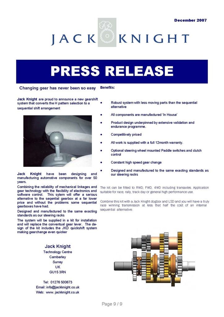

the only  tive speed box with 1:1 fith is the KAD, it always has been. it is all to do with how the five gears are fitted in the box. KAD are the only company to have sqeezed in all five gears into the same place all others have four gears. any gearbox that has the additional gears on the other side of the centre web is an overdrive fifth including the JKD.

I'd like to see more info on those JKD boxes as Ive never seen one.
The ratios were 1st - 2.567:1,   2nd - 2.1:1,   3rd - 1.579:1,   4th - 1.2:1 and 5th 1:1
They were around in the 1990's, maybe earlier.
Pages%20from%20JKD%20-%20Mini%20price%20
These were made well before KAD did theirs. KAD started from the JKD 5 speed with 1:1 5th and developed it further.
<EDIT: Here's the last page from that 2008 JKD Price List that has a drawing of the Gearset layout used in these JKD 5 Speed Gearboxes with 1:1 5th;-
Pages%20from%20JKD%20-%20Mini%20price%20   >
