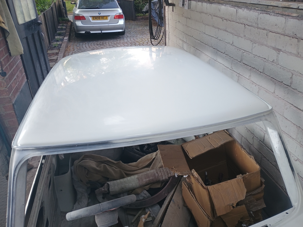

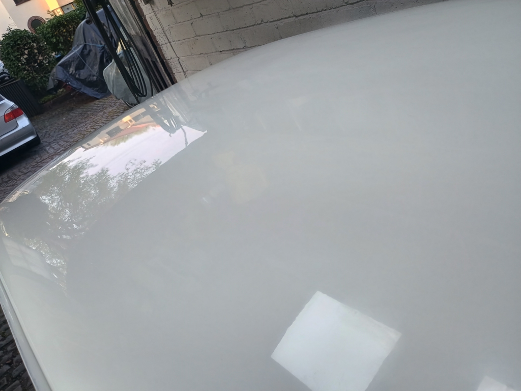

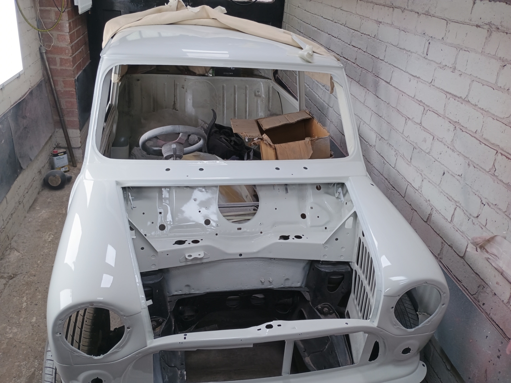

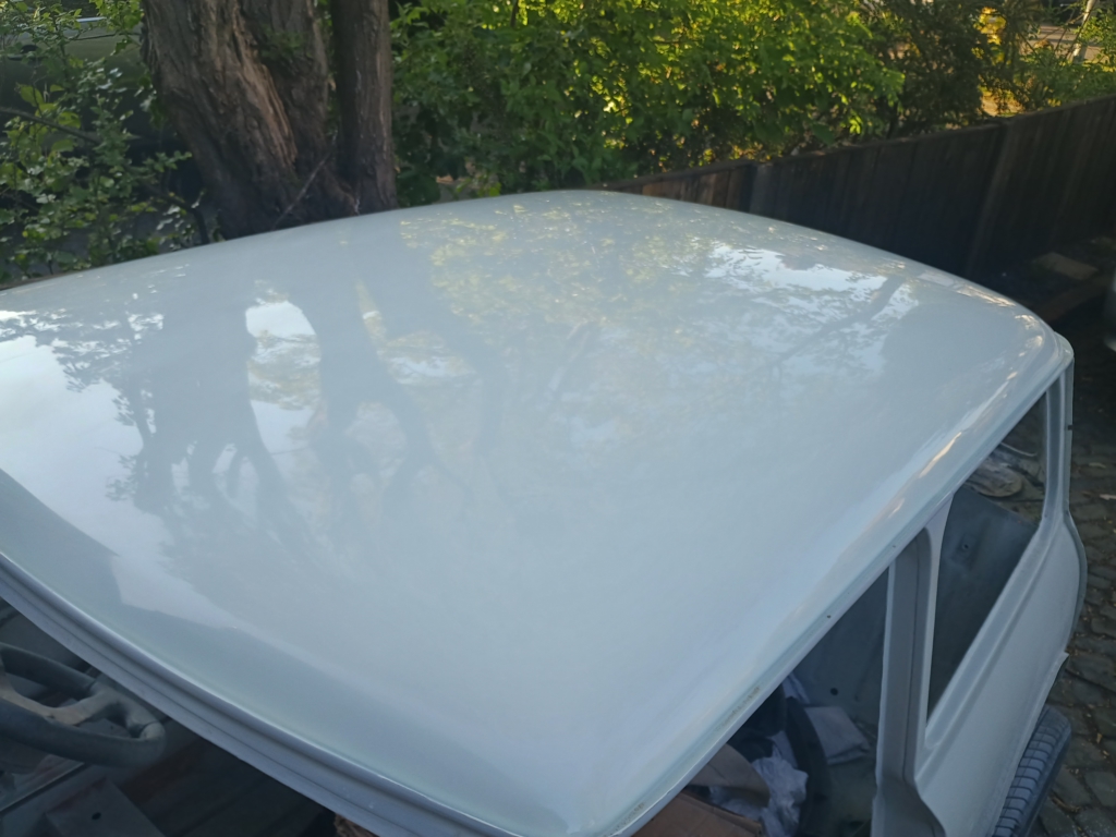

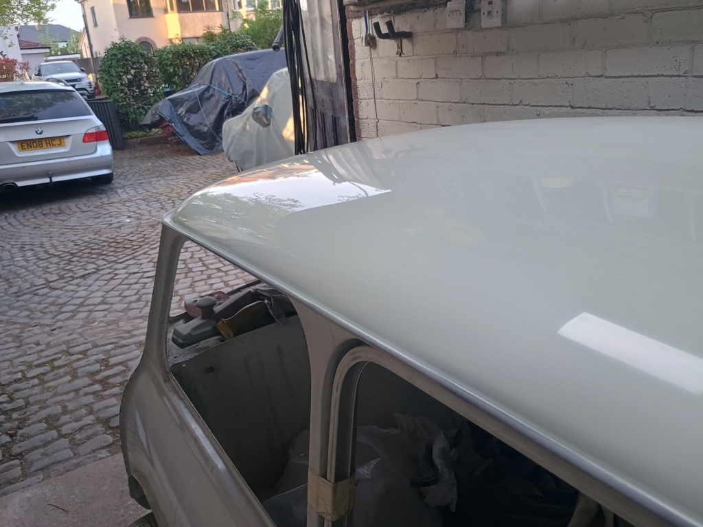

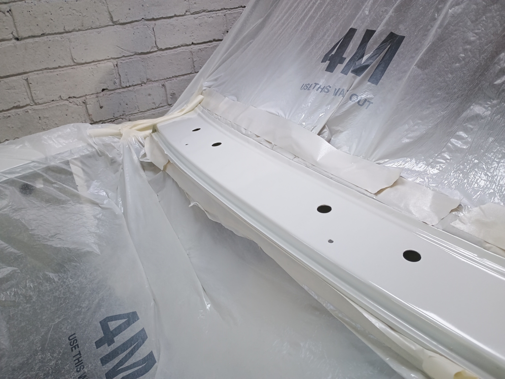

the roof was in primer, so i flatted it today, then thought, its stillearly, can i paint it? so i tried!
and i did paint it
what i had to do was push it out of the garage and paint one side then push it back in and paint the other. the problem was pollen and dirt. So it needs a good polish, but even if it messed up, i know now my painting is good, the finish im well happy with.

That came up real nice, I've painted a car in a tight space like that, and can appreciate how hard it is!
Well done!

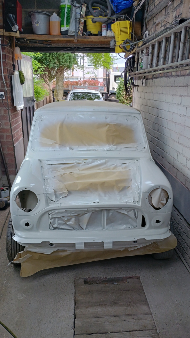

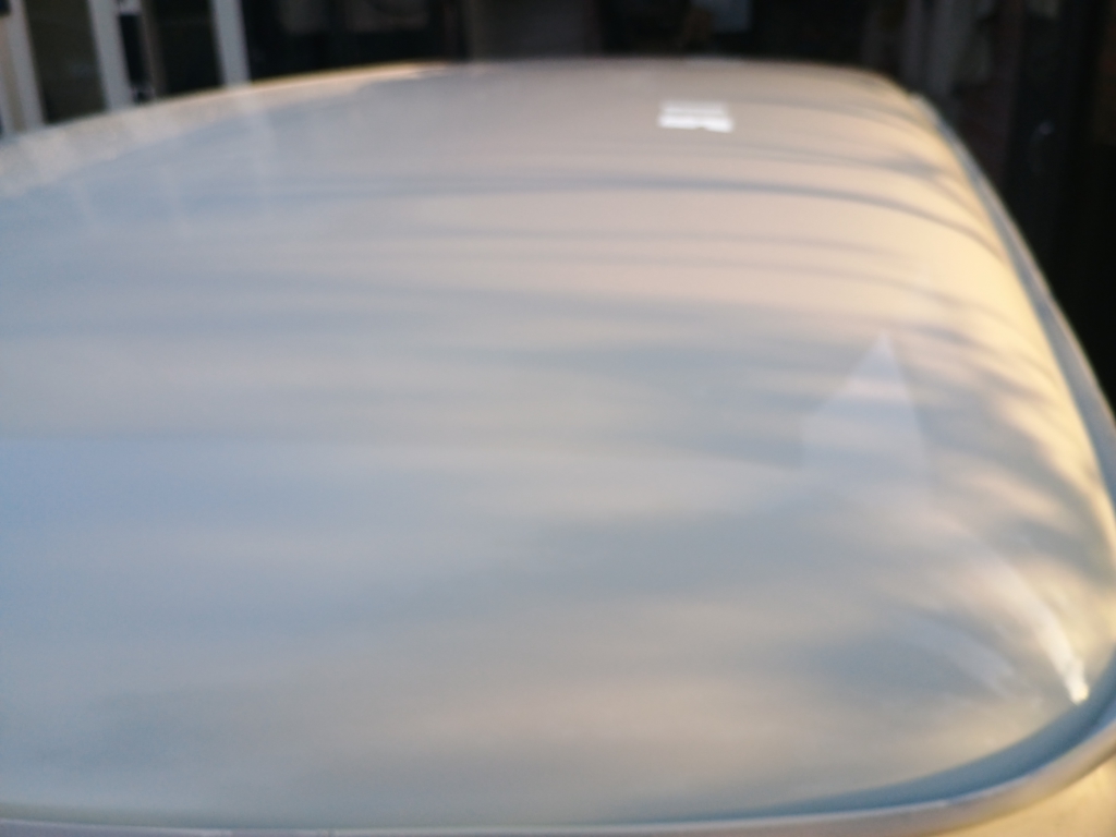

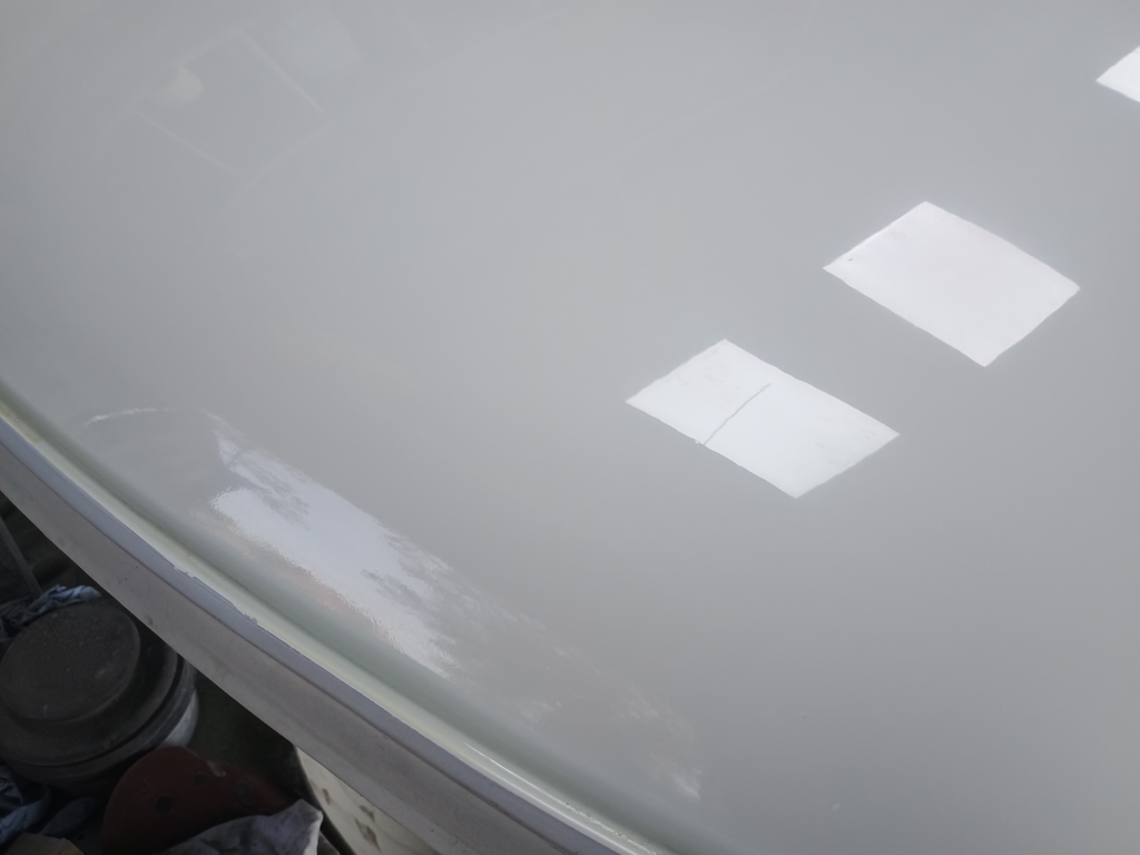

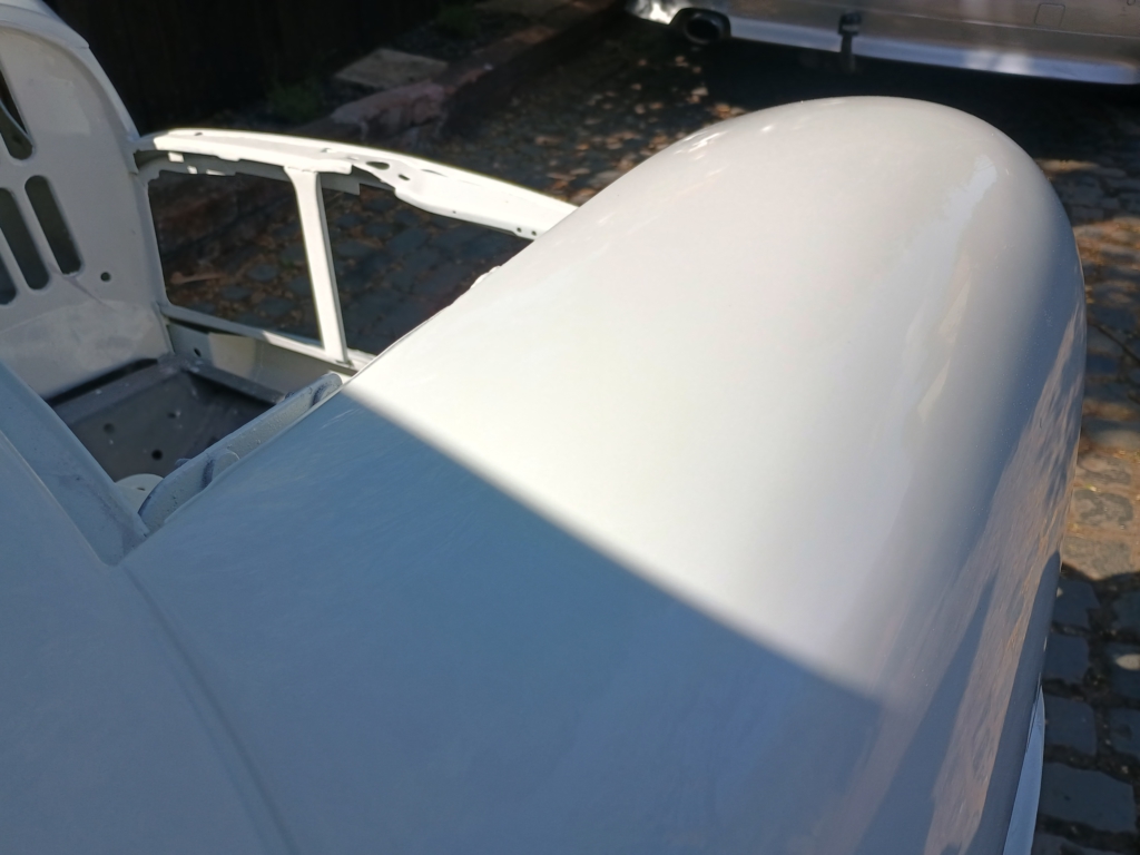

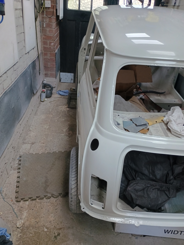

i tried to polish it today, went with 1500 first then 2000, then t cut, i should go 3000 i think also but i had non!
its hard to see int eh pics but i only buffed one side of the roof, and its come out really nice for what it was! There is still some marks, but itll do. The roof is the part that you can see, so with the rest of the car im sure itll look good. So try and paint the front i think next

cracking garage paint job, like the above know what its like spraying in a tight garage. Top work buddy

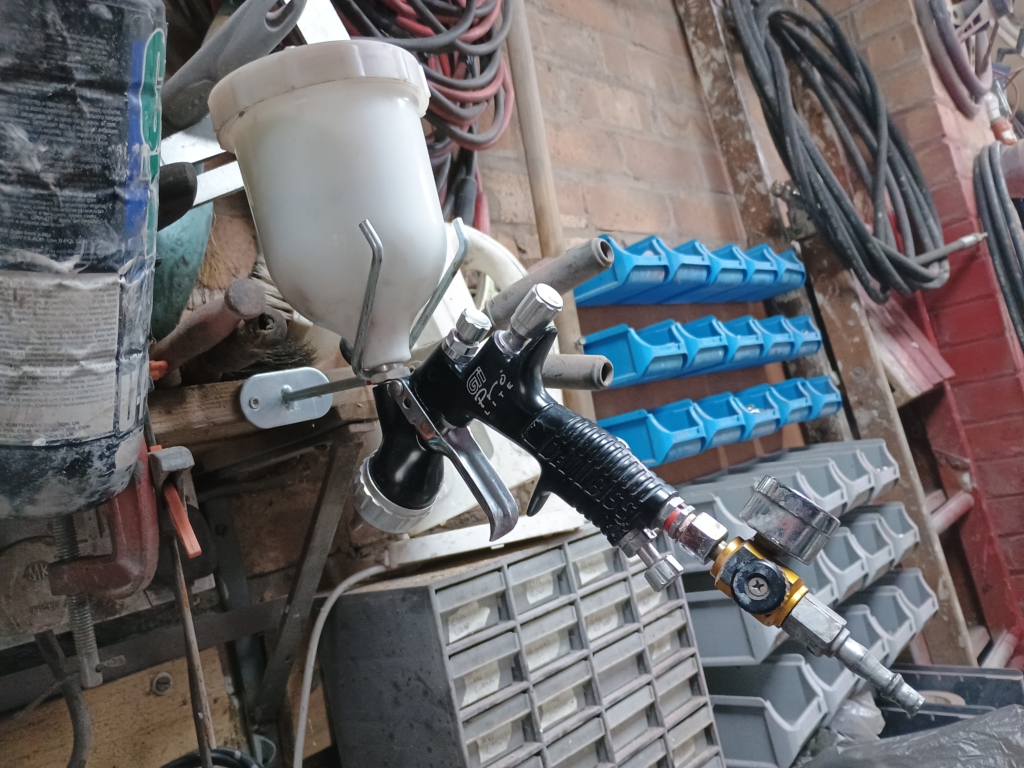

thankyou! its only recently with this new paint im using and the gun set right i can get something like!

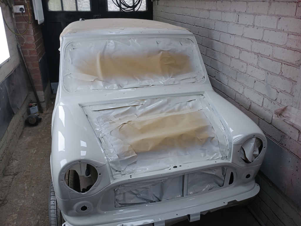

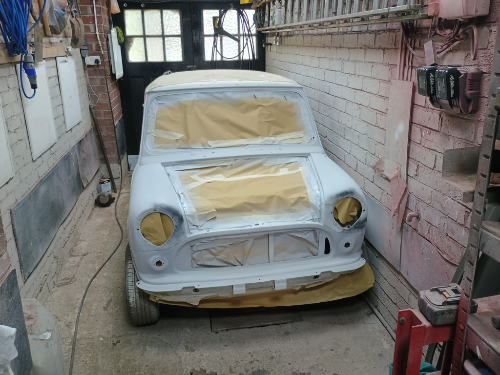

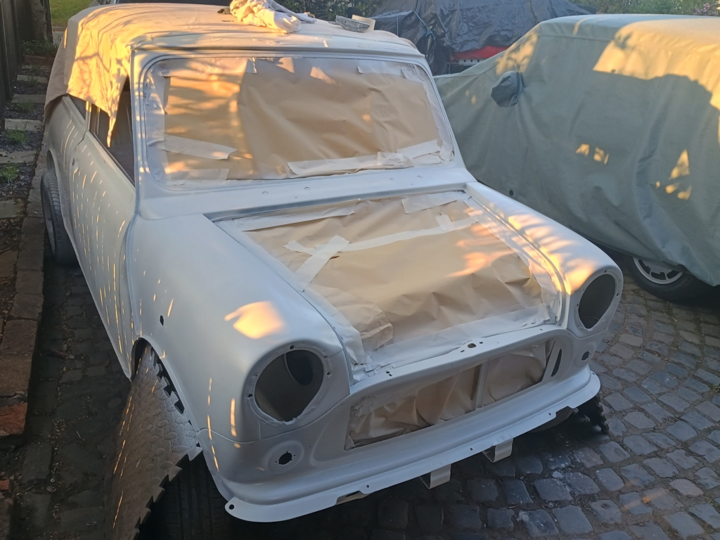

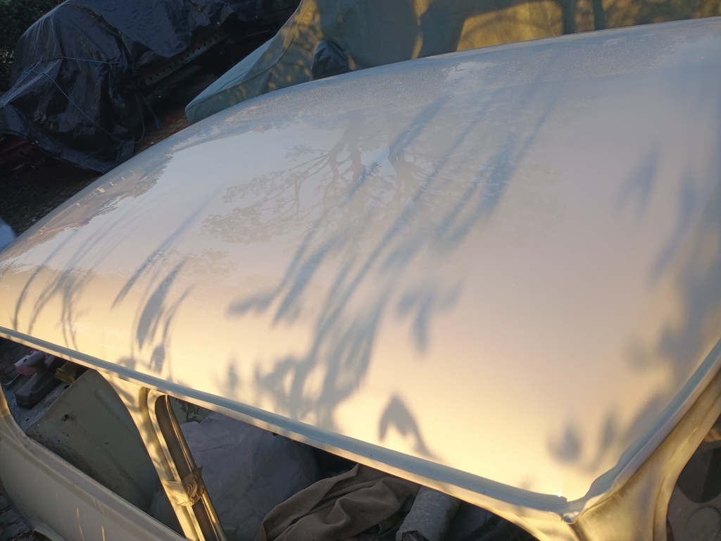

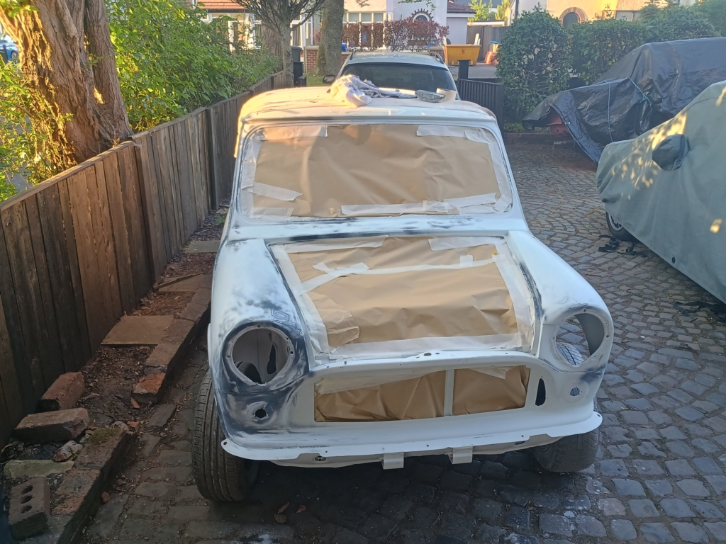

Today i polised the rest of the roof

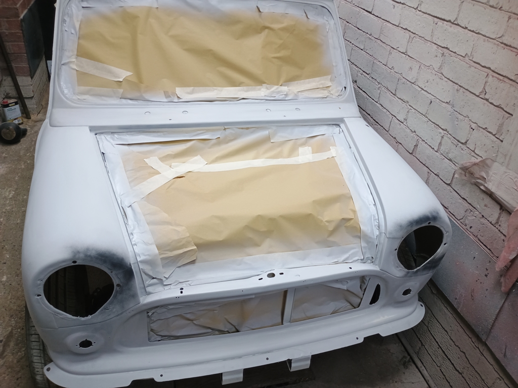

i then decided on painting the front next. So i masked it up and put it in high build
Hopefully get back on it next week, this weekend will be doing the Lada hopefully, but if its too hot i may do some on the mini as the garage is quite cool.

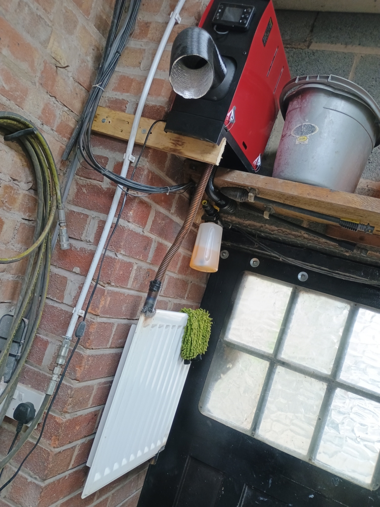

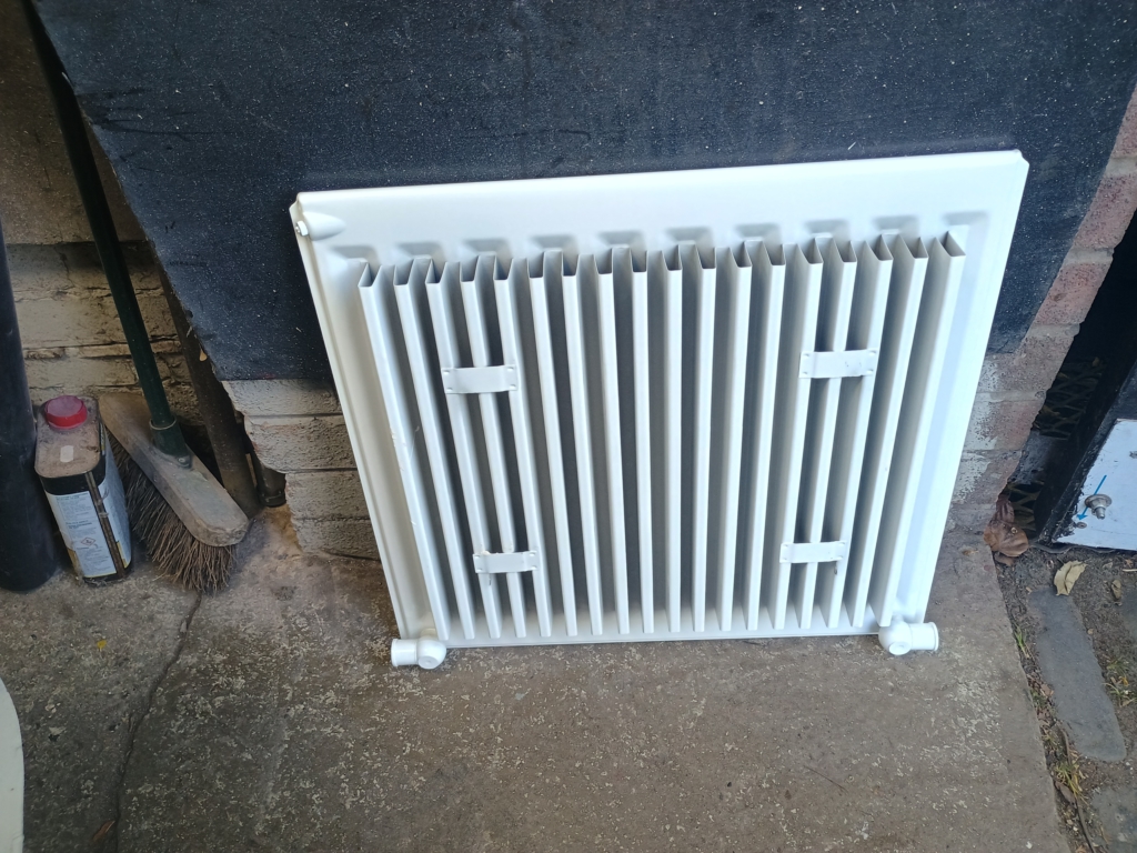

bit more this morning. I bought a radiator for the garage, the exhaust gas out of the diesel night heater is wasted, so if i run it threw this rad, itll recoup some of the energy.
It works well, just need to sort the exhaust out to atmosphere now, and venting it threw the rad i dont need a silencer on it either.

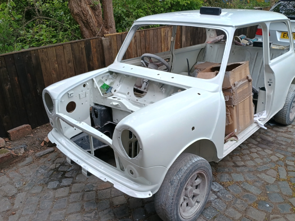

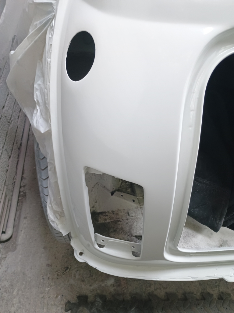

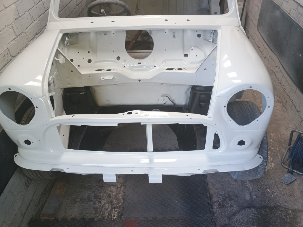

so i painted the front of the car
it came out really well, i had to push it out the garage to paint the n/s wing, then pull it back in to do the rest !

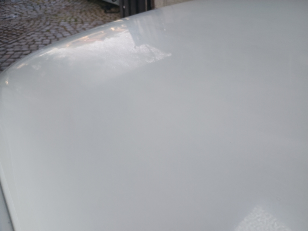

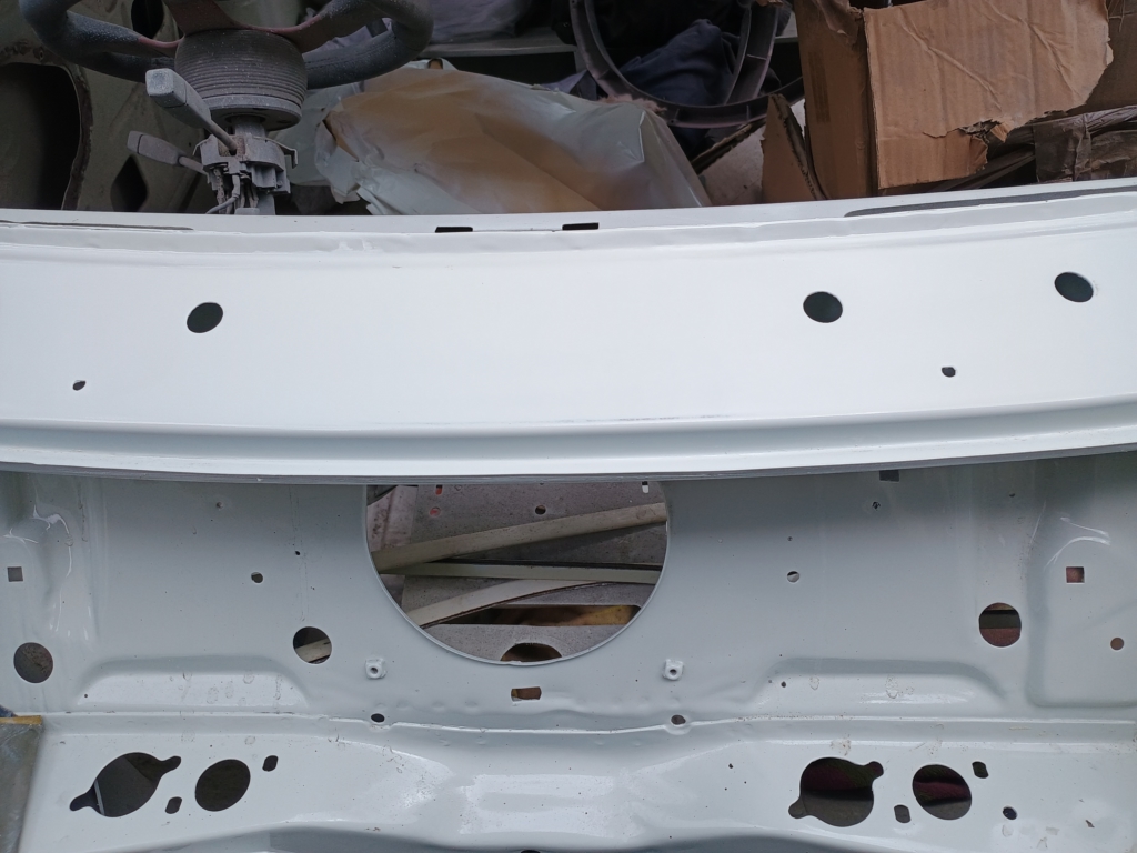

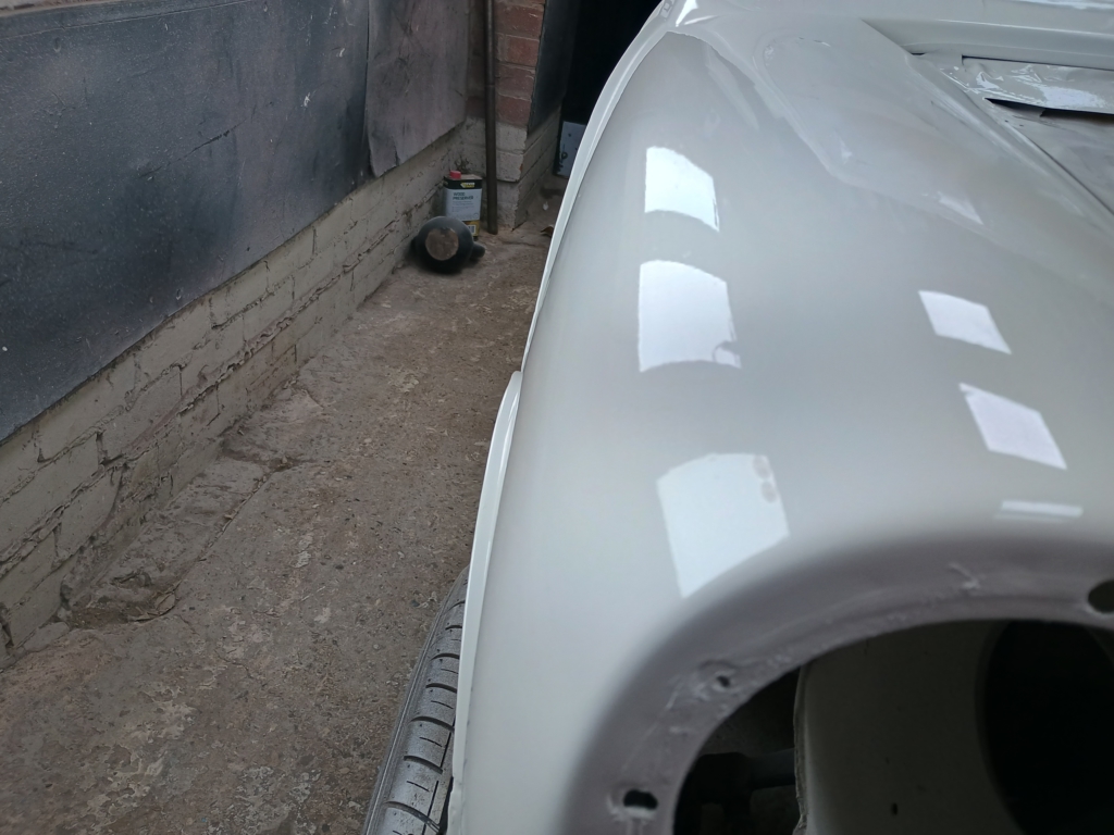

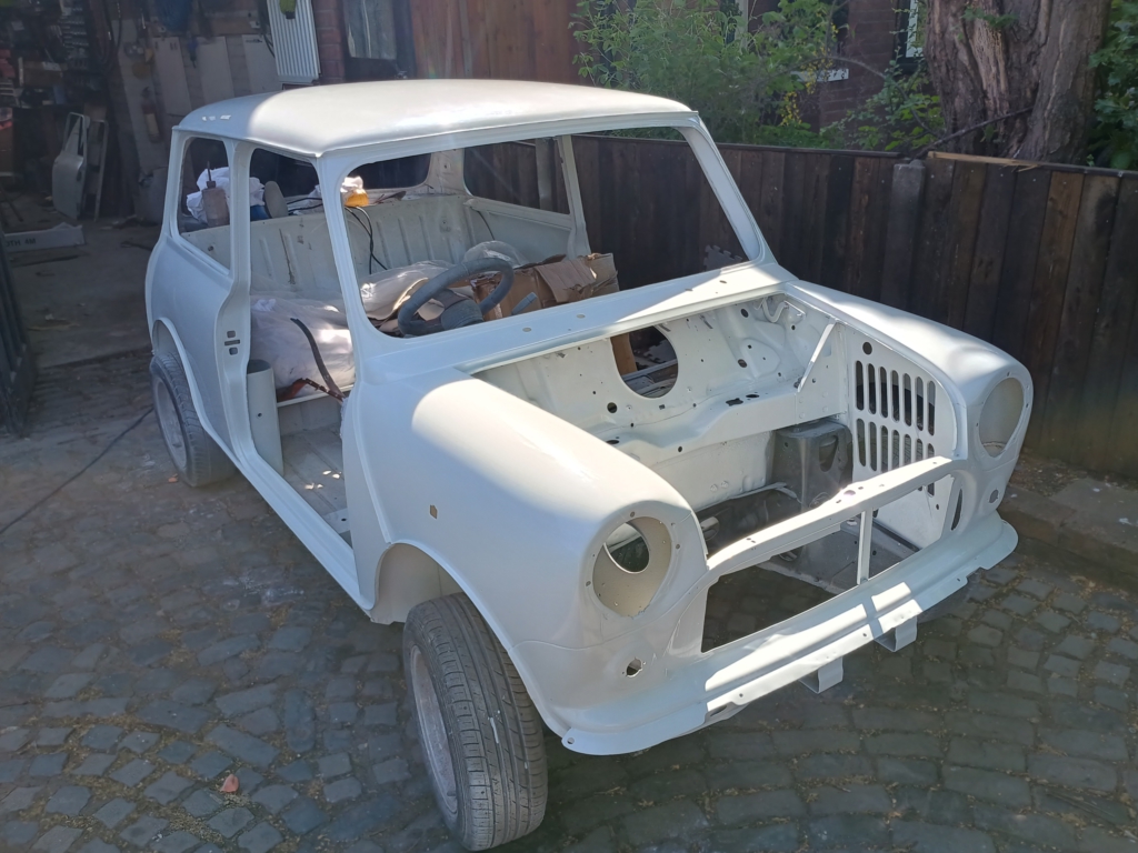

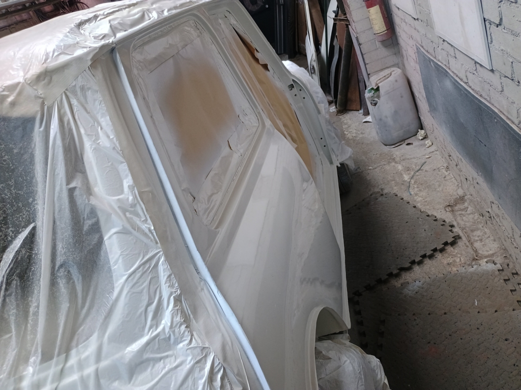

polished the wings and scuttle;

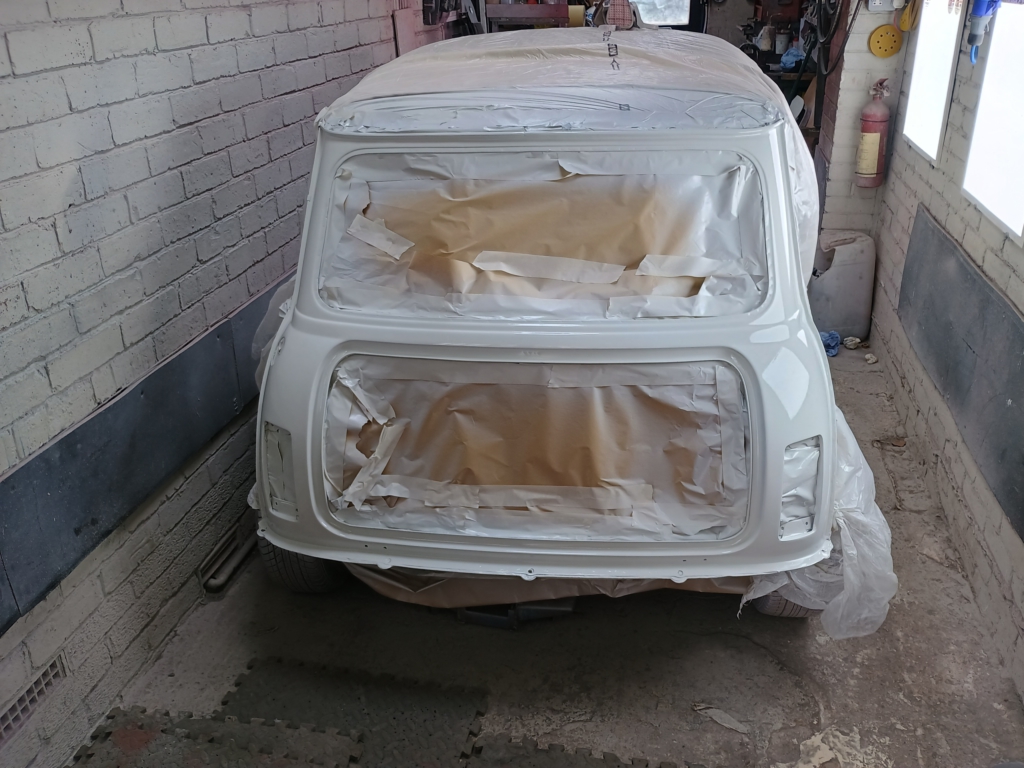

Wings look good, but the scuttle i sanded threw!

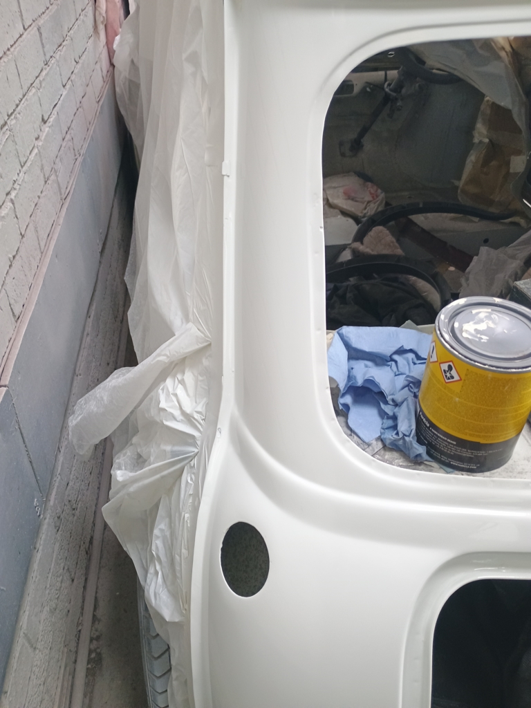

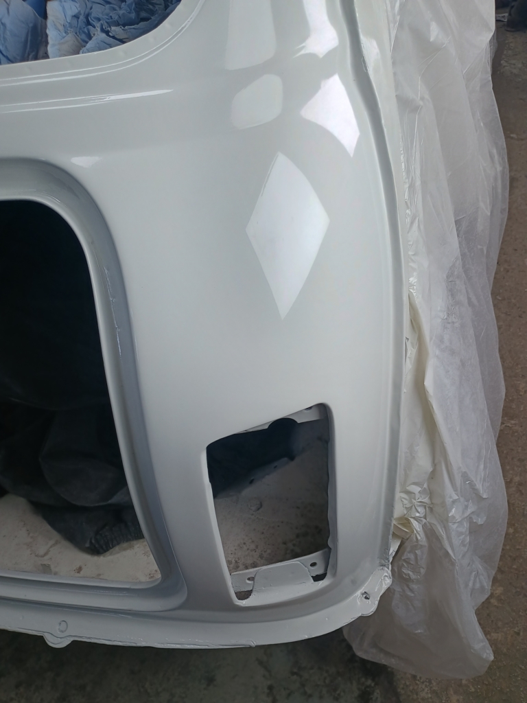

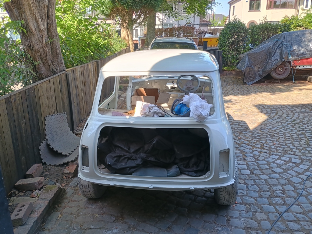

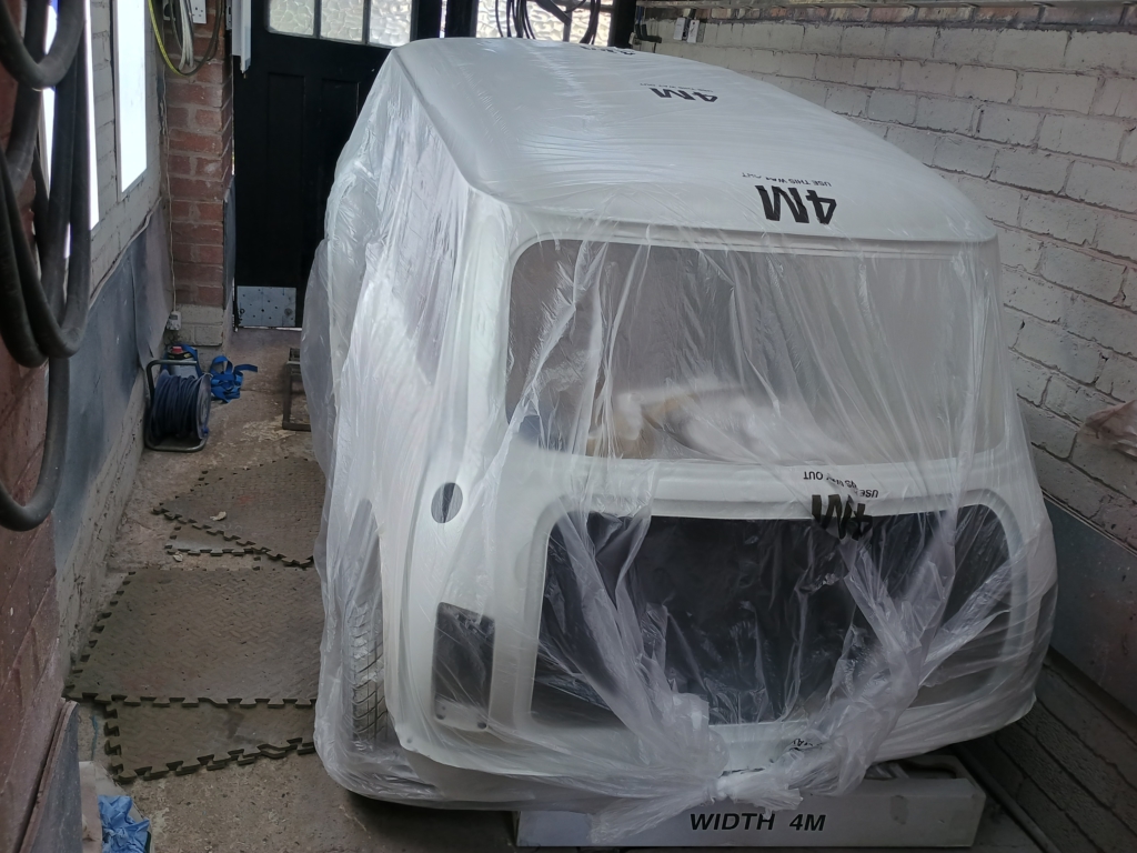

Thought id try and paint the rear
got a little run on the n/s, but hopefully ill be able to do something with it.

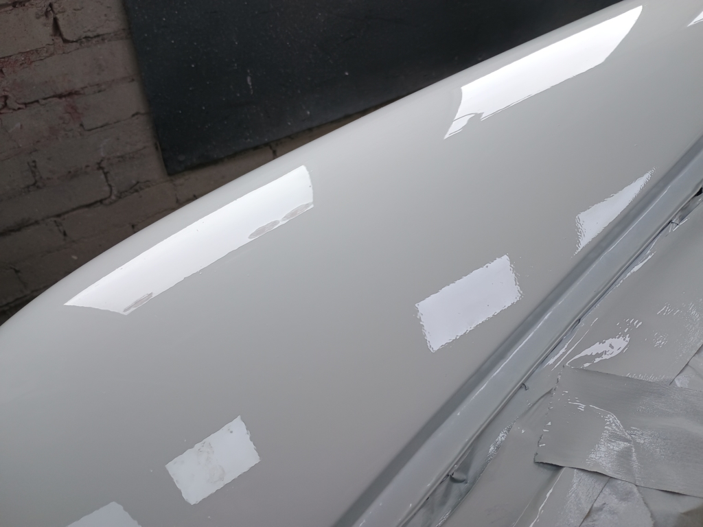

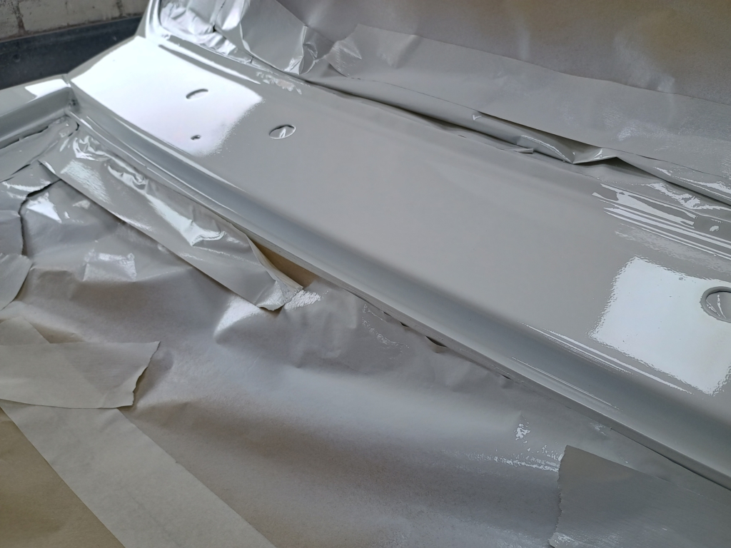

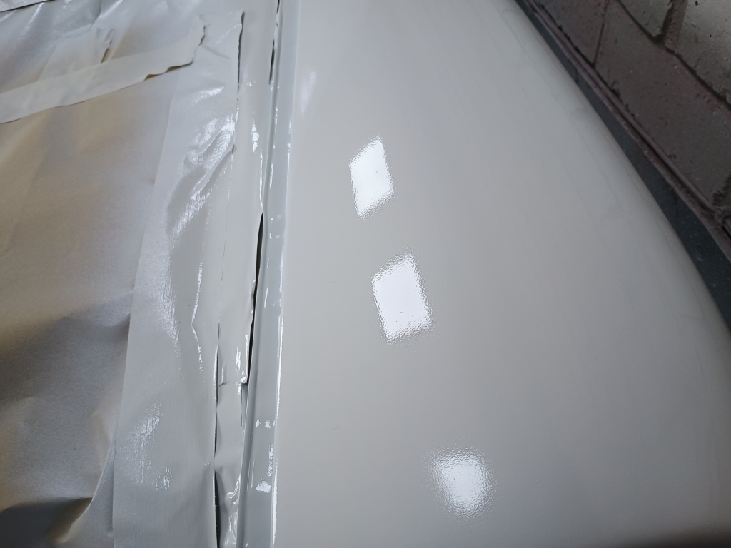

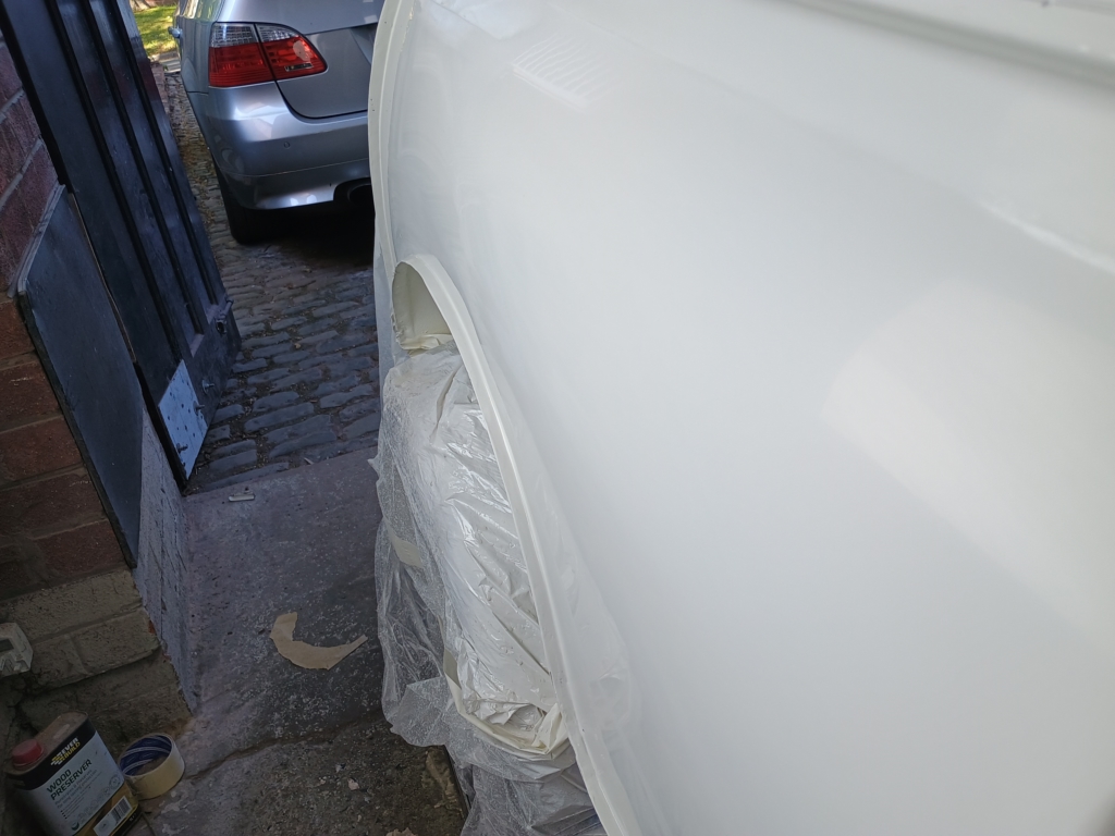

paint was polished today, i used some 1500, then 2000, then a trizak disc. Its made such a difference, polished in no time and looks really good. The runs just went with some 1500.
So i started on the side of the car now...
its ready to mask and paint. Ill do the blow in on the scutle at the same time too.

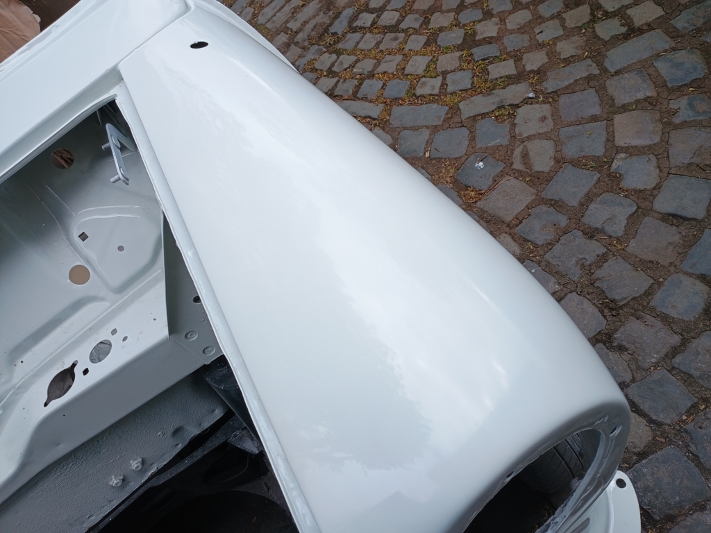

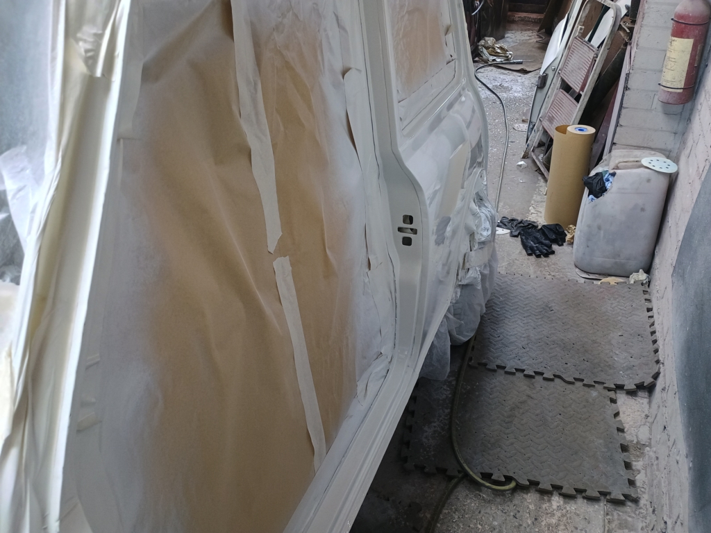

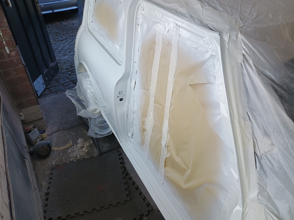

side polished today

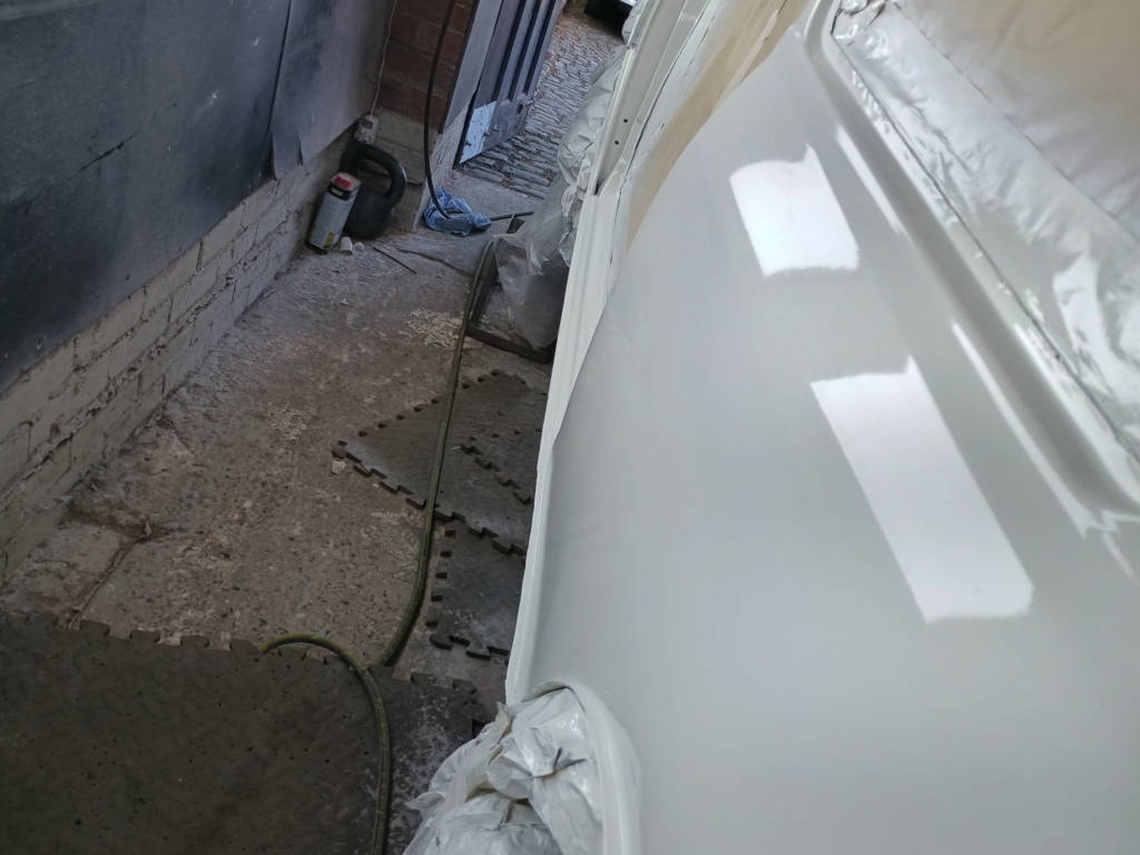

car was turned around and the other side was painted
did the blow in on the scuttle too
went back later and looked at the paint, its really flowed well, got a run ont eh pillar, but im sure i can sort that out..
this is the best panel ive ever painted though. tomorrow either lada work or polish the mini.. have to see.
