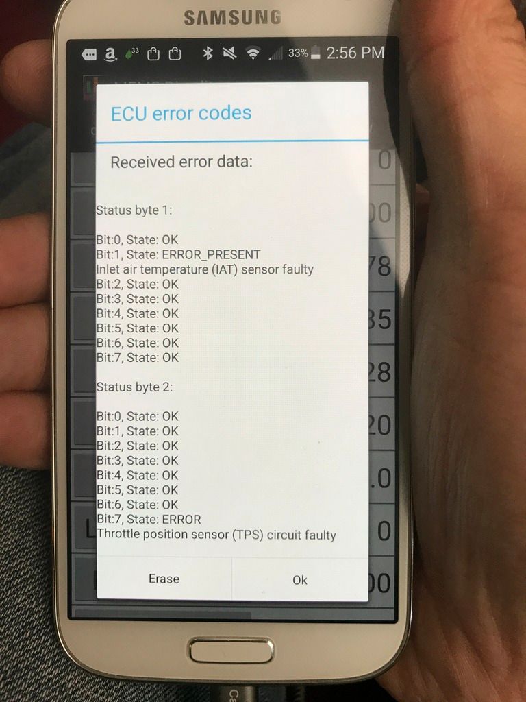

It took me a week or so to get all the parts but they came in and I built my cable to plug into the MEMS unit on my SPi. As I am an Apple guy, the only non-Mac thing I could get my hands on was my fathers old Samsung Galaxy S4 and bought a micro-USB to female USB. Well, it all worked GREAT!! Thanks to Genpop for the amazing directions and links to build the cable and (another) shout out to MEMS_Diag off Google play. I only have the free version as Ihave not setup an account but will shortly and buy it.
As others have said, you have to go into the prefs first to switch to MEMS 1.6 as 1.9 is the default...if you have 1.6 that is. Connected instantly and seems to be running perfectly. The app that is...
Went to the fault codes and found two. Cleared them and ran the car again and both codes were present again. Have a look!
a92e7d8c4848e4d096df49cff9af523607ddabfa
So, being my first time using this app, is it safe to say that these are in fact faults and I should set about replacing? The TPS volts seems to function smoothly with the scanner hooked up but maybe there is something else I guess? Any other explanation for the faults? I would be SOOOOOO happy if these were in fact my issue but hate to through money at things that might be fine.
Also, please see the video of the car while running. Again, not 100% how this reads exactly but it looks to me that the Lambda is not functioning correctly, no? Anyone notice anything else? You get an idea of how bad things are when you bury the throttle. My foot goes straight to the floor...revs sputter and it nearly stalled once.

I don't have much experience with SPI (as an MPI owner) but have scanned one of them before. The IAT code is "normal" - I don't believe the SPI or MPI have an IAT sensor implemented, so all stock Mini injected cars will report an error with IAT. That's the only "normal", expected error I know of.

The SPi does have an intake air temp sensor, located under the airbox.

Ah, most likely my memory is at fault. It may be only the MPI that lacks the sensor, and I mixed that up with the couple scans of an SPI I did a few years ago.
I seem to recall there was a temperature value (which on the MPI is a ludicrous one.) Sorry for the misdirect.

When I first accessed mine, it also had an IAT error. It didn't come back once cleared thankfully but a return would probably confirm an issue. I read in one of the threads that this sensor doesn't make up too much of the fuelling decisions anyway.

The TPS would explain a lot of your missbehaving engine. So first have a look for this. The intake air fault is not so important but should be repaired as well.Intake air temp is always at 27² so the intake air heater beneath the intake manifold should work all the time.rpm is too high,ignition advance is fluctuating as well as map.Map should be between 40 and 100.(see blackbox solutions)Within prefs you could switch to doing a log.Within prefs for the phone you can switch to admin mode, find the log and send it to your mail account.In an VM you may run Al's mems analyzer and see the graphs in a better resolution.
But first have a look for the TPS signal!

The data your talking about Bluedragon is the Ambient air temperature or is sometimes mapped as the fuel temperature and isn't used on SPi or MPi and has a static value of 200.
The MAP should read 100 at Ignition on without the motor running and then go down to between 35-40. If it stays near 100 you have a duff set of vacuum lines or fuel trap (which I always recommend you start off with replacing)
TPS fault can sometimes be physically seen if you remove the air filter and watch the fuel spray from the injector, as you 'accelerate' if it suddenly dumps a load of fuel and the motor stutters the TPS is worn. Careful movement when reading the TPS value should show it suddenly changes (bad track in the pot)

All the vac lines are new proper thick wall silicone and I just replaced the fuel trap as a matter of course. I had the ECU out recently and stuck some Cotten thread up here (no idea if it actually went all the way in) but nothing came out. I have no reason to believe the fuel trap was not working or have I ever seen any fuel drip when hose is removed from map sensor.
Being in the US, doing this can be tough but I'm lucky enough to have my brothers 95 SPi in near by storage. Hoping to get over there asap, scan his car just to make surr and then pull the ECU, air temp, and TPS to test. Provided his are functioning correctly, that might be a good way to see if these are at fault or if would be throwing money at nothing.
What about my lambda readings? That can't be right!
Oh, and the inlet heater on my car is toast. I removed it and it sounded like a maraca.

why playing and searching around. Repair theTPS ,then make a new test. If lambda is working well, you may see with the payed version of mems diag.. There you have some graphs.But as long as you don*t have a continious running engine you need not expect a closed loop.Or try to have mems-rosco running, there you have an extra notification for closed loop.

both show you the same values but in different form.Mems diag reads more fault codes.Anyway it depends on the user if he can  interpret what he is reading.On a rough running engine you will never get a sinus like graph of lambda values.Very seldom the lambda sensor is the origin for rough running!But the closed loop status (sinus like curve) shows if everything else is ok.
Check the TPS!
