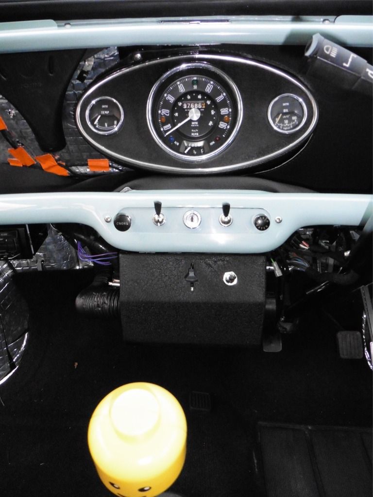

I converted my SPI heater to 2 speed which is the same casing as the MPI. Have a look at post Number 575 in my thread here -----> http://www.theminifo...rebuild/page-39

That looks amazing. Going to have to go through your entire thread. Kinda mad I saw the end before the beginning. It looks very well sorted indeed.
Was wondering what you plan on using for the blower motor switch?

Sorry missed this, thanks!
I'm using 2 toggle switches as like lots of other things I've done, the heater mechanisms modified as well

Did you also modify your SPi heater to look more like a Mki unit?
yep, modified the mechanism so it's up down rather than left right and made an aluminium panel to cover it all, which I had engraved today with off, screen and car.
