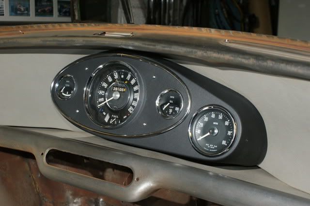

I wanted to put a rev counter in with the 1293 but the one I had was a RVI type which is unlikely to work with the electronic distributors. So I bought kit from this place https://www.spiyda.com/M/ (cheaper on Ebay if you want one eBay item number:380578001095) that fits a new circuit board in place of the old one making it an RVC type comparable with electronic ignition. It needs a few wires soldering and then calibrating with a computer or phone to get it to read correctly which dad sorted out. So it should work with the dizzy now. Anyway I then needed a place to mount it, there's a few choices out there, One being a bracket (which it came with) which could be bolted to the top dash rail and the other neater looking, easier fitting and less hole drilling is the speedwell type with the bulge on the side for it like in the below photo. But that would be the easy way out.
c44d857c63703b1a97e5d0dc5287c6d87e329cea
And with a few trials I came up with this MDF, painted black with some silver duck tape around the edge :thumbsup:
It would have been pretty easy to make if the back of the original binnacle was flat, but it's not so had to get creative with some plastic,
and then with a few steps in between I got this.
and with some hole saws
And thats where I'm at, it needs a bit of work but once finished it will use the same mounting holes as the original. The trim around the outside will be a bit more complecated than I'd like and thought as you can't get anything like the original stuff and apparently the preformed ones that you can get from minispares are stainless and would be difficult to bend and I would also need 2 of them to go all the way around. So I'll be using brass rod for mine ...

Bit more work done on the binnacle this weekend and during the week.
I'm hoping to spray it with wrinkle finish paint but not sure if it will stick to the fibreglass or react? It just needs the holes drilling for the mounts and the trim, the trim bending and plating and painting.

Crackle finish paint won't react if you prime first, even if it does react slightly you won't be likely to notice
