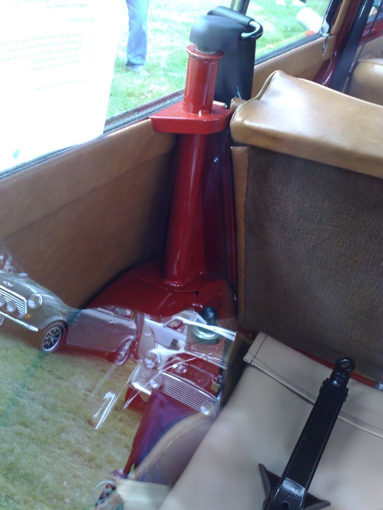

TBBH dont do it. there is not any tested mounts.  back of the seat is a very very bad idea.  here is something half decent but i dont know what reinforcement was done to the fixing by the glass.
http://www.theminifo...te#entry1727456

This is sort of along the idea what I had in mind - making a strengthening piece that goes to something structural on the car. Would do something more elegant that that though.
http://www.theminifo...d0fe8a78920.jpg

the problem is there is nothing really structural back there so you will need to add quite some metal.

That post mount would be no good in a crash, the mount at the top has loads of leverage on the base.
There's no strength in the corner piece at the top or the window channel it's attached to.
I'd say you'd need at least 2 tubes well spaced out and preferably bolted through the arch to spreader plates underneath, much like a small rear only roll cage.
You might also need a bar between the 2 sides to stop them pulling into the centre of the car  but that could be removable for when the seat is down.
Think about the forces involved, weight of person X speed.
When the car comes to a dramatic halt, as it would in a crash, the person carries on at pre-accident speed...
Cheers  :proud:
