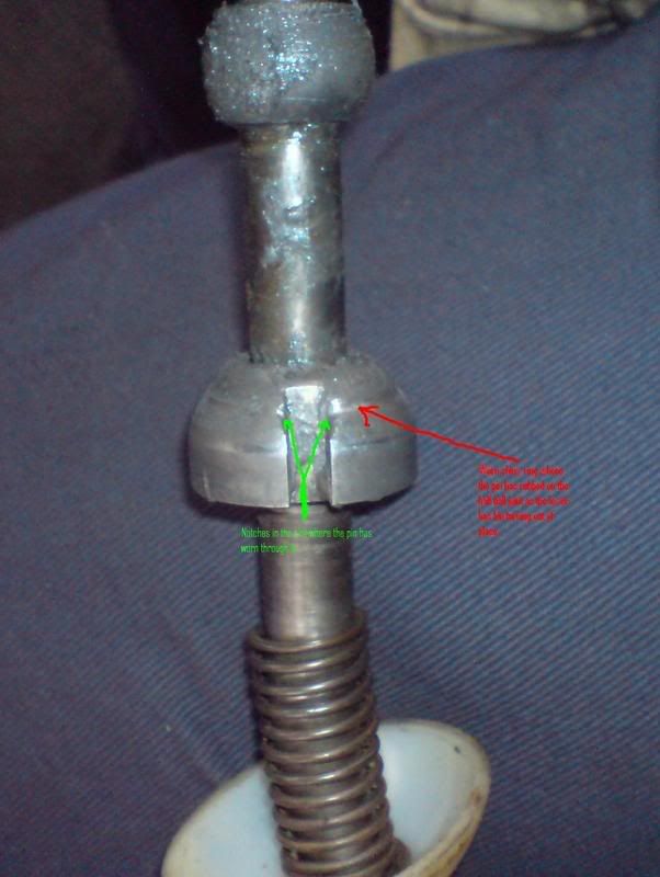

The gear lever wasn't just not moving propperly but it also was turning too. The lever will spin a full 360degrees with nothing really stopping it. So i had the lever out and had a look and this is what i saw:
There is a notch where there should material to stop the lever turning by the pin fitting into the slot.
i'm thinkin its time for a new gear lever then? where from and how much?

kad quickshift isnt too expensive!! not sure about std ones!! mini at the scrappers!! just bear in mind the actual rod change box mite have a worn pin rather than the lever being worn!! or BOTH!!
EDIT: sorry look on www.minispares.com or www.minisport.com!! minispares first tho, i rate they're delivery!! minisports has let me down a few times!!

do you know of any scrappers that might have one? and how do i go about checkin wether the pin has worn in the selector box?

just look down!! by selector box i mean the place the lever that u pictured came from!! shud be a nice square edged pin!!
oh ok well i'll have a look tomorrow n let you know.
