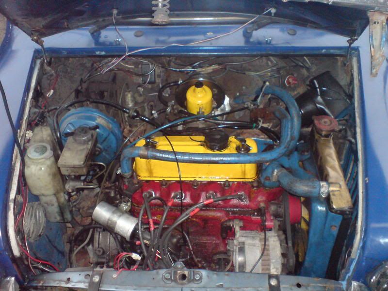

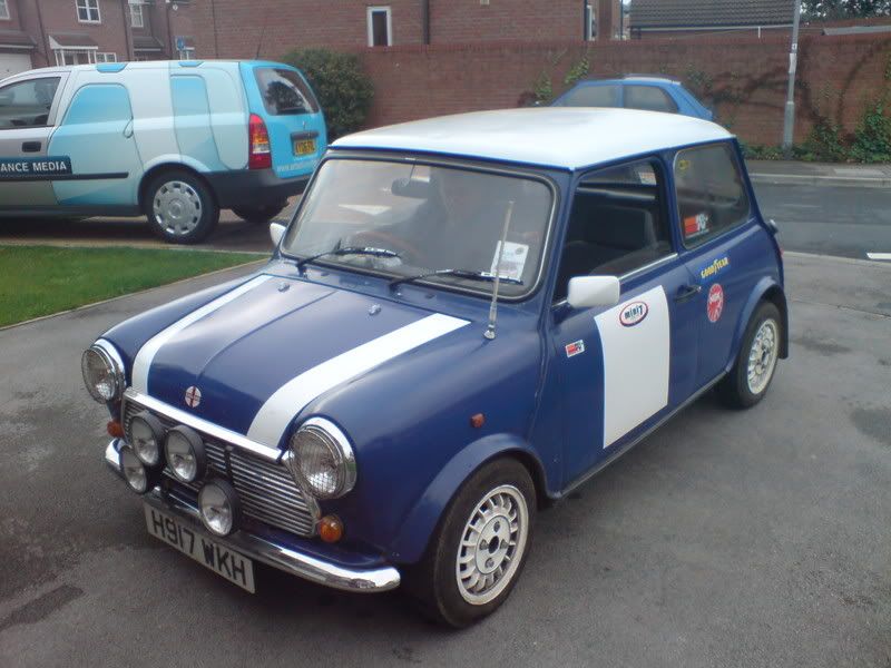

this is the mini by the way: Posted Image

#26 fikus01
fikus01
  • 1,910 posts
  • Local Club: SMAG - Southend Mini Action Group
Posted 19 October 2006 - 10:16 PM
looks cool, bit ott with painted engine parts and the yellow rocker box is a bit loud for my liking but then again im building a bright orange racer with a black flip front, who am i to yell about loud colour choices!!!! very original looking set of wheels by the way, not seen them before!!
#27 adcyork
adcyork
  • 490 posts
Posted 19 October 2006 - 10:25 PM
cheers mate, yea i'm not too sure on the rocker cover and carb being yellow myself, i think i'll rub them down n polish them up. but for the time being it works so its staying as it is ;D
