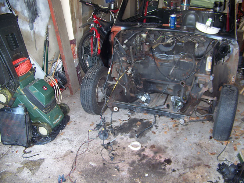

The starter relay is mounted on the driver side inner wing to bulkhead cross member support. It's not inside the solenoid, at least not on a late 80's car.
This isn't the perfect picture but:
f5314a7277784fb966e49bb3166532709525f288
You can see the starter relay on the inner wing to bulkhead crossmember support, in the picture it's a grey cube.
Check the relay is present and the contacts aren't corroded. It should receive 12v on the white/red wire when the ignition is in the START position.
