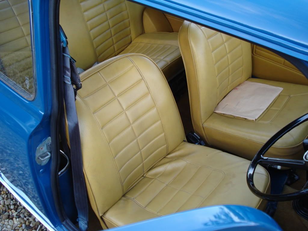

I'm sure on my 74 Clubby they were fitted on the outside of the bin in the same location as yours. I'm going to have a trawl through my pictures to see if i can confirm this.
#9 sonikk4
sonikk4
    Twisted Paint Polisher!!!
  • 16,074 posts
  • Name: Neil
  • Location: Oxfordshire
Posted 08 May 2020 - 05:50 PM
Yup, i can just make out the inertia reel was on the outside of the bin. You just about make out the belt going down the side of the bin
