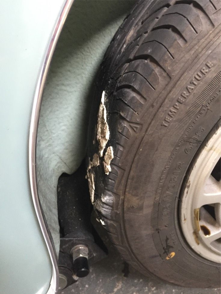

Buy cheap, buy twice (or even thrice!).
My case this year. Not anymore...

I learnt the hard way, a minispares rear wheel bearing done around 500miles and seized solid when I was going 60 MPH, Got away with it quite lightly in the grand schemes of things just a knackered tyre, radius arm and hub.
